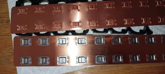

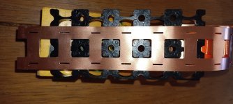

WooHoo the turtle boat from China arrived. I've now tested 4 different welding options and spoiler alert, the winner by far is the copper/nickel composite bus. After finding out my Kwelder couldn't weld a 0.2 copper/0.15 nickel sandwich, I tried it using 0.1 nickel but I wasn't much better even at 500j. I couldn't trust it. Next I tried a sandwich of 0.1 copper/ 0.1 nickel. this actually worked pretty well at about 125j. Lastly Mr EE and I tried the copper composite. It's some pretty impressive stuff. It made great solid welds at only 100j. This is what it looks like. The copper is 0.3, but they did some kind of magic trickery at the weld point. What I don't fully understand about the weld point is on one side it's nickel, and on the other side it's copper. I thought it would only be nickel. In Chinese they told me something is 0.12, which I assume is the copper, but what abut the nickel? They told the truth when they said it would be very easy to weld. The only thing I don't like about it is it this kind only fits 21700 cells glued together, but I'll deal with it.
