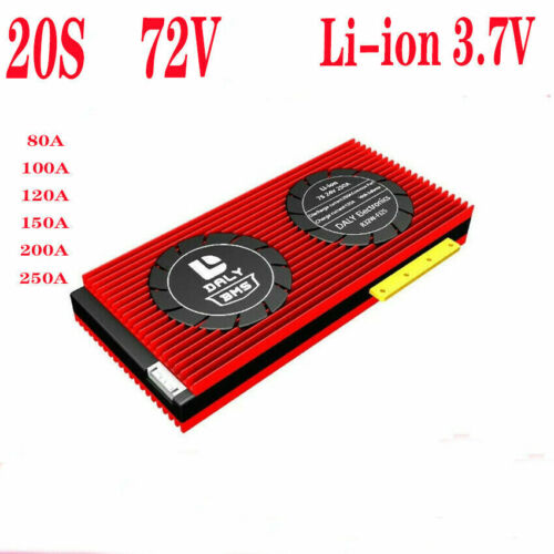

I plan to use Samsung 50S, 25 amp drain cells 20s 7p. I don't expect ever running over 100 amps, but I'd like to have a 120 amp capable BMS running at less than full capacity for longevity. Please recommend a good spot welder, and BMS.
This is a BMS I found, but I'm not sure It's what I need. I might end up running the BMS external of the pack to save space. I have a cavity in my frame just above the battery where the BMS can go. Can anyone explain the difference between common port, and a separate port BMS, and which one is better for me??
Common port, charging and discharging are done on the same port on the BMS. Separate port, there are two ports, one for charging, one for discharging.
Situations when common port is best include using regen and when parallel connecting two batteries as this allows the BMS to still be able to shut itself off if overcharged. Whereas with a separate port bms, regen current and current from another battery pack that is coming in through the discharge port cannot be shut off even if the pack is overcharged potentially causing a dangerous situation.
Separate port is only really a thing because it's cheaper I believe, if anyone knows more reasons please correct me.

Appreciate your helpful replies. I'm going to have to show my ignorance by asking some more questions. It sounds like if the charge wires are connected to the battery output terminals, like with a Common Port BMS, wouldn't that bypass the BMS when charging? Would it be correct to say most common eBikes sold online have a BMS that would be considered a Separate Port BMS?

No it doesn't bypass the BMS protection when charging. It's more than just connecting the charge wires to the discharge port, the circuitry inside a common port BMS is different such that the BMS is able to shut down current in both directions on it's one output/input. Whereas in a separate port bms, it can shut off current flowing out of the battery on the discharge port but can't block current flowing in. (So something like regen could overcharge the battery since it can't block the charge current) Then vice versa on the charge port, it can block current flowing in, but can't stop current flowing out.
Can't say for sure which most bikes have but probably separate as most bikes don't have regen or any reason to need a common port and separate port is cheaper to make.
Edit: One still does typically attach a separate set of charge wires onto the discharge port with a common port bms, just for convenience otherwise you'd have to unplug your controller anytime you wanted to charge.

Ok, that works out better because most of the BMS I see online are Common Port.
A question that's come up is, if the battery pack is 20s 7p, can you use a BMS that's 20s 10p, and just not use the last 3 charge wires, or does the BMS have to exactly match the battery pack?
BMS doesn't have a "P" number, only S, because all cells in P are already connected together and thus use the same balance/sense wire from the BMS.
Cells in parallel don't count as individual cells to a BMS. X# of smaller cells in Parallel is the same as a single large cell.

After a little more research on BMS, I see that the one I referenced in the op is a passive BMS. Active BMS seem to be preferred. Would this one be a better choice? The physical size is good.

Yesterday I ordered one of these BMS, and a K Welder. A 100 amp BMS is the biggest one of these that will fit in my frame so that's what I ordered, and that's the same size as I have now. I chose this one over the Daly BMS because I don't like the idea of balancing by burning off high cell voltage with a resistor. I live in Texas and my battery already has to live in a hot enough environment without making even more excess heat.
