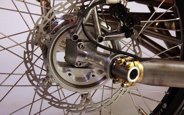

Here is another bike with in-hub steering, for reference:
^very nice,
http://www.flickr.com/photos/titchmarsh/with/9980695304/
http://www.titchmarshcycles.com/portfolio/the-scorpion-cargo-bike/

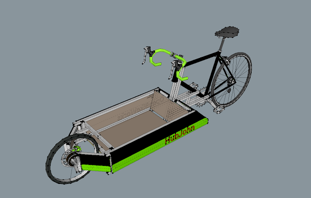

seen these two?
http://openbikeworks.blogspot.com/2012/01/not-alone.html
http://www.pedelec-forum.de/forum/showthread.php?2261-Sport-Lastenrad/page2
http://stahlrahmen-bikes.de/stahlrahmen-hersteller/vorne-roller-hinten-mtb-sports-utility-bike-alias-cargo-dragster
file.php
http://openbikeworks.blogspot.com/2012/02/alternative-solutions.html
