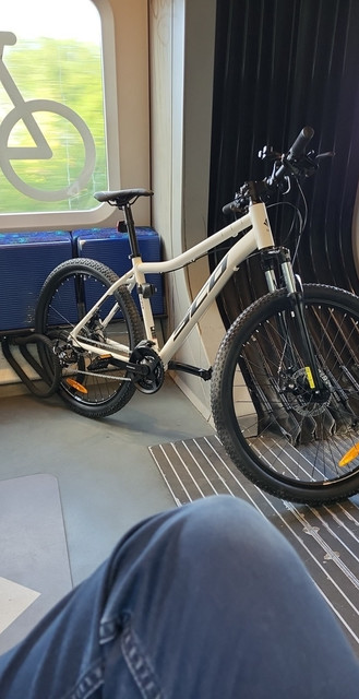

I've had a 48v 1000W kit conversion kit laying around for 2 years (Aliexpress). I sold my car and now I'm looking to do my first eBike build!
Originally I planned on making a sleeper dutch bike, but I have lowered my own expectations due to difficulties finding a suitable bike for a 27,5" hub motor wheel.
Donor bike
I bought a cheap brand new (ladies)MTB bike for ~300 euros new:
![](/sphere/proxy.php?image=https%3A%2F%2Fi.ibb.co%2FbXfkgcG%2FMTB.jpg&hash=0d080d8a9f6b3a48deea9947163b7764)
As the MTB was relatively cheap, I was expecting the front suspension fork to be made of steel as I have read on the forums that aluminium forks are a death trap, eventho I have seen people on the forums make it work with 500W+ motors without issue.
I did a magnet test on the fork - unfortunately it seems to be made of aluminium.
I've decided to go forward with the project anyways, as I have not been able to find a cheap steel front suspension fork from an EU supplier - I have no knowledge about size and fitting, installation etc. More on that later!

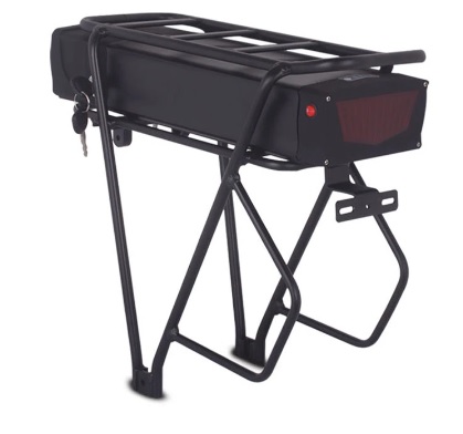

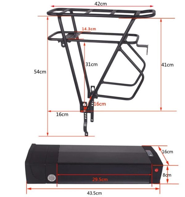

The battery will be housed in a rear-mounted battery rack:
![](/sphere/proxy.php?image=https%3A%2F%2Fi.ibb.co%2FXSDFxfb%2Fbatteryrack.jpg&hash=fec05c01054acd155cbcc084010fdf6f)
![](/sphere/proxy.php?image=https%3A%2F%2Fi.ibb.co%2F1z1BfmQ%2Fbatteryrack.jpg&hash=e08d3f5fda9527a5333cc5581168800b)
I have asked the supplier - it will fit a 13S6P 21700 configuration.
I will be using Samsung 50G 21700 cells @ ~4800 mAh for value. Impressive cycle life @80 % capacity after 1000 cycles. (Ordered from EU-based Endless Sphere member turmich - see his selling thread of many different cells and packs here)

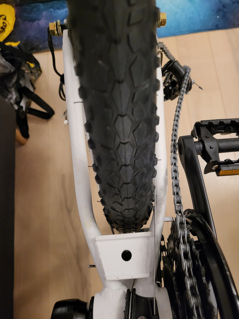

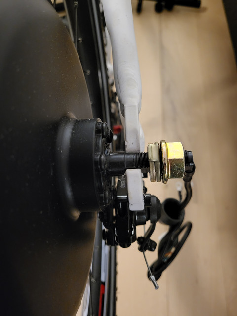

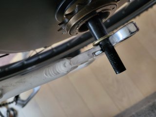

Hub motor on aluminium front suspension fork
This is a topic that I have done lots of research on, and rightfully so it seems. I would love to write this section, as I feel it will probably be most important to my own safety, but right now it's really late where I live, and so I leave you with your imagination.
I will update the thread tomorrow - hopefully with more pictures aswell.
