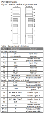

I am now working specifically on the inverter type of modules but simply can not get them to work so far. I tried measuring and manipulating all possible data signals on the connector, but can not get it to communicate via can bus and therefore can not control it / enable the output.

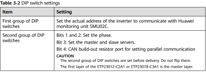

I already found out, that this kind of module seems to do not have the auto addressing functionality that the rectifier modules have and therefore need static addressing (set via resistors, which I could not exactly determine because I do not have an original enclosure for it, but by a bit of trial and error found a combination where the module does not simply signal an slot error but still no communication is possible)
The main problem is, that there is zero communication comming from the module (as there is with the rectifier modules), also sending a lot of different messages to it made no difference, I even tried to brute force it, but with 29 bit of possible addresses and a nearly infinite amount of possible data combinations, there is really no big chance to get it working this way. I tried the northbound and southbound can bus at different states at the other pins, I am also 100% sure the whole communication chain is working properly, as if i plug a rectfier module into the same connector everything is working perfectly and with both types of modules only at the correct 125 kbit/s there is no immediate can bus error if I send messages to it.

I believe there must be some kind of unlocking sequence build into it (I am not sure if it is implemented in hardware via pins or software via can bus) or if it is only to protect people from mains output voltage or to lock us out from using it externally.

Does anyone of you have an ETP23003 or ETP23006 enclosure and can reach out to me, so we can do a few measurements? (I think we will be able to get it working in a very short time)
