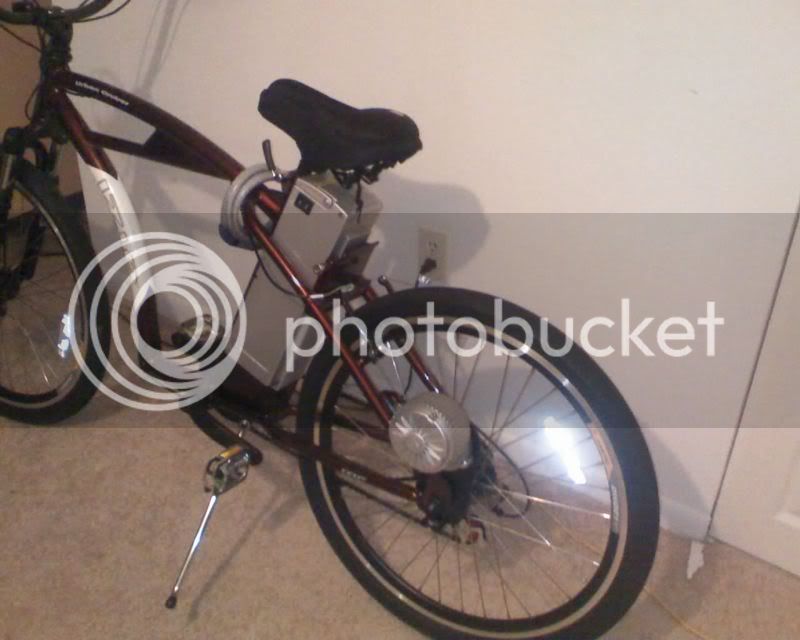

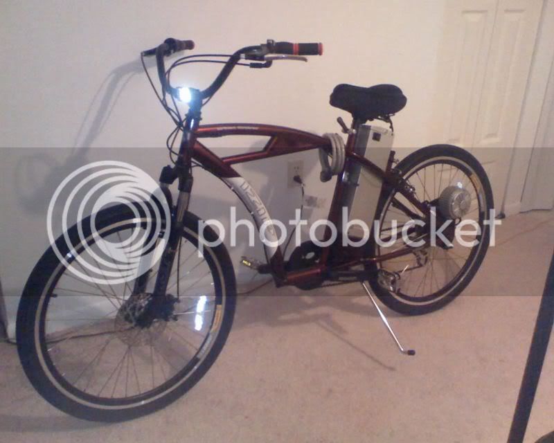

Thougth about getting the mongoose after seeing knightmb's review but could not find any in the walmart stores in South Florida.
Decided to go with the izip urban cruiser mainly for the comfort and look since the mongoose and the izip have the same spec. (see knightmb mongoose review)
Dennis from BernsonEV.com gave me a great deal on the bike. it's about $100.00 more than the Mongoose's online price which include shipping and tax.
I've been riding my new izip urban cruiser for about 2 weeks now and I love it exept for the range.
The advertised range is misleading, I don't get close to 25 miles advertised, more like 15 miles with assisted pedaling. Status light starts going red (low) after about 10 miles. Since owning the bike, i've never seen the status light go green (high) I'm 185lbs, no hills.
I'm seriously thinking about adding extra batteries to extand the range, i'm new to the ebike world, so I would not know where to start. Any ideas?
Here's the spec with pics.

It goes 11.5 miles on 24 volts and will do 18 miles on 36 volts as tested by members.
Buy/borrow a new set of 12 AH batteries and swap them out and see if you get any improvement. The ones it came with may be old. If you find your range is much better with new one's contact Currie and have them covered by your warranty??
Just a thought.
Nice and smooth looking bike. I like the head lamp on the front, nice touch. As others have already posted, it can faster and farther without too much modification to do.

Nice frame on that thing! Looks like a longer than normal wheelbase, good for other purposes. Huge area to carry more battery.
As to range, now you know. Cut ALL manufacturers claims for range in half. In some cases, cut speed claims too. Still, that's very good range for an sla pack. Put that thing on some lithium after a few months use of the sla's and you will really be happy. But for now, if 15 miles is enough, you are set for the summer. :mrgreen: Or set for a year, if you ride less than daily.
