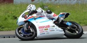

Check out Isle of Man TT e-motos if you haven't yet.. generally it's single speed to the wheel, a few teams use transmissions, and aero cleanup for efficiency gains.
Team Mugen started crushing so hard lots of other teams gave up.
Personally, I think this is one of the most beautiful, form following function motorcycles ever created.
But as written earlier, for basic street commuting, hub could be fine. Quiet, low maintenance, no dirty chain spraying your work clothes... Lots of pluses for reliable commuting.
