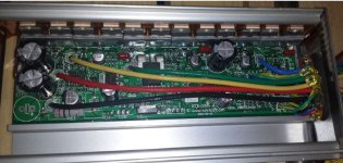

This is a picnic mobile. I can bring my wife, kid, food and fishing pole all around town.
I built the kickstand really strong so the bike can be used as a park bench and table when parked.
I had Hallomotor pre-wire the system so I would not have a head ache.
I cannot figure out how to remove the speed limiter from this. The LCD panel will not set the controllers for any more than 24mph. It will set the controllers for less, but not more. At 24 mph this bike is only using 300W. It will do 24mph when lifted off the ground in place with no wind resistance and the same 24mph with two adults and four kids on it. It has two each of these batteries, hub motors, and controllers.
Batteries
http://www.hallomotor.com/2015-latest-48v-23-2ah-panasonic-cell-ncr18650pf-seat-tube-li-ion-battery-with-slim-aluminium-case-charger-and-bms.html?acc=e369853df766fa44e1ed0ff613f563bd
Controllers
http://www.hallomotor.com/48v-1000w-brushless-dc-sine-wave-ebike-controller-regenerative-function.html?acc=e369853df766fa44e1ed0ff613f563bd
LCD panel
http://www.hallomotor.com/24v-36v-48v-ebike-intelligent-lcd-panel-lcd-display-for-our-sine-wave-controller.html?acc=e369853df766fa44e1ed0ff613f563bd
Hub Motors
http://www.hallomotor.com/2015-new-style-black-48v-1000w-brushless-gearless-cassette-hub-motor-for-rear-wheel-ebike.html?acc=e369853df766fa44e1ed0ff613f563bd
Do any of you people know how to take the speed limiter off? Do I need a Cycle Analyst, or buy some new controllers? What gives? The fine people at Hallomotor have not been able to help me yet. I am awaiting there response. They have helped solve issues in the past, so I hope they can this time- or maybe someone out there? anybody?
