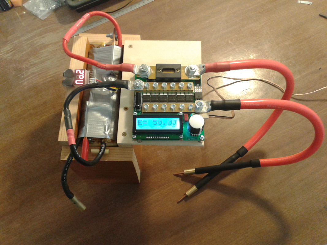

I’ve had a look at your kWeld ultracapacitor module.
Have you given up on the HP DPS-800GB Server PSU option?
No, I’m just doing the capacitor and the charger modules sequentially. Despite the fact that the charger prototype is working reliably and just needs a PCB redesign, I went with this order because the capacitor module can be used with a regular power supply, but there is not much use of the charger without something to charge.
Cheers
Frank

Could two boards, as designed, be connected in series to power the welder using a 12V power source?
I plan to make a variation with 5S2P that will be 12V capable, if there is enough interest in that. I didn’t go for this in the first place because that adds another ~50€ cost, and the one that I am doing now will likely be good enough for up to 0.3mm pure nickel.
The comfort zone for kWeld is 1500A, with as little voltage as possible (that reduces the likeliness of arcing and improves electrode lifetime)
Your calculations and conclusions are all valid, and your 6S1P conclusion is exactly the reason why I didn’t go in this direction. Your 6S2P variant is certainly related to putting two kWeld-cap boards in series, even though I think that it is a bit overkill, I am sure that you won’t have any compromises with that. I would recommend also testing them in parallel, because that will significantly reduce their losses, which again improves the available repetition rate and their lifetime.
Cheers
Frank
