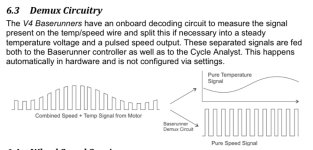

I have an older Phaserunner (V2) and a CA-DPS. Looking at a few different motor options from Grin, I was wondering if anyone knew how to connect the L10 motor standard to the older JST with regards specifically with the combined thermistor and speed signals coming from the L10. I could leave the speed disconnected and use the speedo from the CA-DPS, but how can I route the temperature to the CA-DPS?
This is the cable I am looking at, and I am a bit confused how I to deal with the 3-pin speed/temp signal. Any advice is appreciated. I have an e-mailout to Grin but haven't heard back yet.

The L10 Harness to JST has the following pinout (1 =N/C, 2= Temperature Input, 3 = Speedo Input), while the CA-DPS has the thermistor input (1 = Gnd, 2 = NTC).
There is a note in the PR manual, IIRC, about how the speed/temperature signal is multiplexed to go into the PR. It shows the resulting waveform, etc.
The CA can't demultiplex this signal by itself, so you would have to use the separate speed and temperature siganls from the PR to feed the CA. (or build a circuit to do it)
If your PR doesn't support the multiplexed signal input and have separate outputs to the CA, then you'd probably have to go into the motor and disconnect the speedo from the temperature signal, and run it out separately if possible, or just use temperature from the motor and use an external wheel speed sensor.

V4 and up have the demux circuitry.
The V2 doesn’t seem to have this circuitry. I also don’t see mention of thermal rollback and the pinout for a temp sensor in the V2 manual.

Given these replies, I wonder if the only plausible solution is demux the signal and feed them to the CA for accurate speed. I would need to pop open the CA to replace the hardwired speedo.
