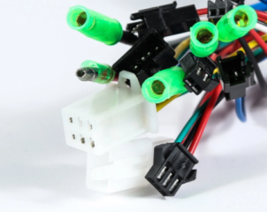

So, I got a ezee hub motor from Grin that comes with an L1019 on it. I'm trying to connect it to an old ebikeling controller that uses 3x phase (green, yellow, blue) bullet connectors in conjunction with a 5-pin block JST for motor connection (I believe it's the same as this one: Shop eBikeling's 36V 500W Brushless Controller with LED/LCD - Precision & Performance!).
What is the easiest or most logical way to connect these? I only need the basic motor to controller connection for this (no regen, reverse, cycle analyst etc). Just whichever makes the motor turn and that's it. Seems the multiple thin wires on the controller JST will be a pain to cut and re-terminate. Should I cut the L1019 off of the motor and convert somehow from that end?
I bought Grin's adapter to JST thinking it was what I needed, but of course it doesn't match (L10-Controller to Anderson+JST Motor Adapter).
