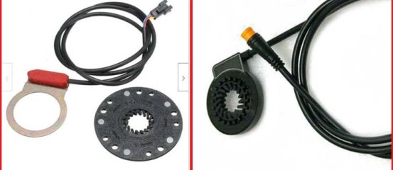

Less than 1 turn will activate the pedal sensor. DId you trace the PAS sensor cable back to the controller connection?Does it use the round Julet connectors or the flat connectors? The flat connectors are easier to porbe.
Both have only three wires. Two are power and ground, and the third one flips between 0 and 5 volts as the disk rotates.

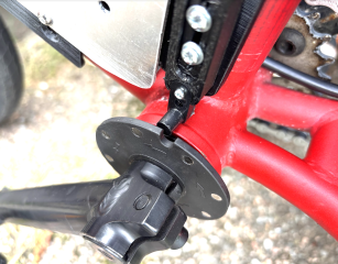

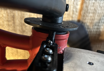

Okey! So I have found the issue and my pedal assist is now working!
This orientation of the sensor did not work (custom bracket):
But this worked:
I thought hall sensors didn't care about orientation?
Pedal sensors are directional. The pulse pattern can signal if you are spinning forward or backward. You don't want the motor to turn on if you're just positioning the pedals at a stop so you can push down to start. With those design constraints, I guess 90 degrees off was too much,
Okey, good to know. Thank you!
