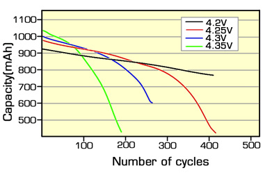

I thought that the Lithium batteries in our cars/bikes will last longer if we don't discharge them to a low SOC. ThunderSky and other manufacturers have some graphs that prove this assumption.
Tesla is having a different approach:
The other significant factor that affects calendar aging is the charge state of the battery during storage. At higher charge states cells lose capacity faster. This is a second reason why we have limited our maximum state of charge to 4.15V/cell instead of 4.2V/cell. We also offer the driver the option of charging to only 3.8V/cell (~50 percent) or 4.10V/cell (~90 percent) to further extend calendar life if the full vehicle range is not needed on the next few trips. We advise and encourage a full (4.15V/cell) charge only when it is needed.
OK, Li-ion and LiFePO4 are not the same chemistry but maybe this approach could be better for LiFePO4 too.

There is quite a bit of literature on this for cobalt based cells. I think Lipo and LiFePO4 will have similar characteristics. Calendar life is adversely affected by time spent at a high state of charge, and it gets really significant at or near the charge cutoff voltage. A lower cutoff voltage will help there. Temperature is very important also. They don't like heat. Above a certain temperature, damage can be immediate. Otherwise, the time weighted average temperature will greatly affect calendar life. Overheating due to excessive discharge rate can easily push the innards of the cell into the instant damage range.
Cells can be immediately damaged by overdischarging them as well and using the full capacity (deep cycle) is bad for the cycle life.
Ideally you'd want to store cells around 50% soc if you were going to leave them for a long time. Of couse you'd need to charge before you go anywhere.

Found a few things with LiFePO4, but it's for 1C 100% DOD only, not a SOC compare.
Effects of LiFePO4 and temp:
Here is more good stuff, but sadly for LiCo not LiFePO4.
" The practical voltage limits are a consequence of the onset of undesirable chemical reactions which take place beyond the safe working range. Once all the active chemicals have been transformed into the composition associated with a fully charged cell, forcing more electrical energy into the cell will cause it to heat up and to initiate further unwanted reactions between the chemical components breaking them down into forms which can not be recombined. Thus attempting to charge a cell above its upper voltage limit can produce irreversible chemical reactions which can damage the cell. The increase in temperature and pressure which accompanies these events if uncontrolled could lead to rupture or explosion of the cell and the release of dangerous chemicals or fire. Similarly, discharging a cell below its recommended lower voltage limit can also result in permanent, though less dangerous, damage due to adverse chemical reactions between the active chemicals. Protection circuits are designed to keep the cell well within its recommended working range with limits set to include a safety margin. This is discussed in more detail in the section on Protection . Cycle life estimations normally assume that the cells will only be used within their specified operating limits, however this is not always the case in practice and while straying over the limits for short periods or by a minor margin will not generally cause the immediate destruction of the cell, its cycle life will most likely be affected.
For example continuously over-discharging NiMH cells by 0.2 V can result in a 40 percent loss of cycle life; and 0.3 V over-discharge of lithium-ion chemistry can result in 66 percent loss of capacity. Testing has shown that overcharging lithium cells by 0.1 V or 0.25 volts will not result in safety issues but can reduce cycle life by up to 80 percent."
