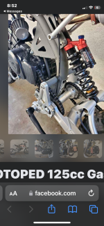

I think I found a bike or maybe the frame. Is this frame smaller? I think this frame style is made in both a “pit bike” size as well as a larger for the motoped
I’m bummed the jackshaft doesn’t allow room for a bigger sprocket.
