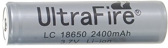

I noticed that he sells some Li-Ion batteries for $6 each, am I right that they are Li-Po?
They're of the same chemistry of typical LiPo(LiCoO2). They wouldn't be referred to as LiPo, however, since they lack the polymer solvent that's typical of flat packs.
