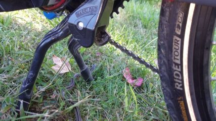

Howdy y'all! I finally finished my Surly Disc Trucker eBike conversion for long-distance touring!
I call it the Surly E•D•LHT (Electric Disc-brake Long Haul Trucker). :D
As some of you may know from previous posts & comments I've made, I did a custom build based on a Surly Disc Trucker frame & wheelset last year & always intended to eventually convert it to electric. Unfortunately I was in a really bad car/bike crash (door opened into me from the right, pushed me into fast moving traffic on the left, was immediately hit by an SUV) & my bike was mostly totaled, though there were some salvageable components. I had a few broken bones & have this annoying scar above my eyebrow now but was very lucky to have survived and without any serious permanent injuries. Took some time to recover & won a lawsuit after that. Once I was all healed up & able to use tools again I decided it was time to rebuild my bike & finally get the motor & battery I wanted to create my dream build. :D
I recorded my entire build process on video & intend to eventually go through it all, do some editing & put together a tutorial or maybe a few. I made another topic about this last month to ask y'all's advice about good video editing software since I'm pretty new to the game of making videos (photography has been my jam for quite some time though). Here's a link to that thread: https://endless-sphere.com/forums/viewtopic.php?f=6&t=107988 (also check it out if you're interested in seeing more build pics from before it was finished!)
I'm so thrilled with this bike & excited to show it off that I just couldn't wait to put the videos together before making a build thread. :lol: :p So here's just a few of my favorite photos of my bike so far! Also: read on for more info on how it's working out :)
The Nitty-Gritty
I got a 14s7p large rectangle battery from EM3EV that so far has proven to be a great choice. The EggRider v2 display I bought seems to have some trouble calculating its watt-hour capacity (it usually shows around 400wh on the display when the battery is charged around 90% but EM3EV lists it as a 1200wh battery). This concerned me initially but after riding it around plenty & having the EggRider v2 seem to correctly calculate my Wh/Mi when compared to my actual range the numbers do strongly suggest the battery capacity really is 1200wh & the BMS Doctor app finds no faults with the battery. The EggRider also keeps telling me my remaining range is much lower than I know it actually is (it said R6 at one point today but then I pumped out 15 miles & still had 33% capacity left so that's just wrong lol). I tried calibrating the voltage through the EggRider app & although that did get the voltage & battery percentage indicators to line up more closely it didn't seem to effect the Wh-capacity or Range calculations. Not really sure what the issue with that is or how to fix it still, but it's really only been a pretty minor annoyance since functionally everything seems to be working perfectly well.
I did make one mistake when ordering the battery & the bag to put it in. I originally intended to mount the battery in a bag within my front triangle in order to keep the weight mostly centered on the bike, but it didn't actually fit there on my 46cm/XS frame. The battery is QUITE hefty & slightly larger than expected. It fits barely inside the triangle on its own but not with the few mm of fabric around it when placed inside the frame bag I got. Even if I had been able to squeeze it in it didn't seem like a good choice since there'd be no room to add any protective foam padding to keep it from getting banged up against the frame. So I ended up buying a trunk bag that it fits into (also just barely lol) & moved some heavier items that I normally carry in the rear (like my u-locks) into the middle frame bag to help offset/recenter the weight a little bit. It is a bit rear-heavy this way but it's not terrible. It's actually working pretty well that way so far. I used layers of 5mm EVA foam cut to size to pad the top of the rear rack underneath the battery bag & put some inside the bag on the sides & top of the battery to help protect it from any dings from the bike tipping over or anything like that.
I've ridden about 150-200 miles on it so far in various conditions & environments (looks like tomorrow will be my first time in the rain though...wish me luck!) & it's all working like a dream. :mrgreen: I've been averaging around 10-12 wh/mi on most rides so far & have even had rides where I only used ~8 wh/mi, which is much better than I had anticipated. I expect that the battery will give me a range of about 80-120 miles per charge when I'm using it on long-distance tours (~100mi average, give or take a little depending on weather, terrain, & how much climbing or descending I end up doing on any particular day).
I have a 42t narrow-wide Lekkie Chainring & a 11-42t 10-speed cassette in the rear so my hill-climbing ability is just absurd. The 42t chainring is a little bit on the small side for me when the bike is unloaded & riding on pavement but it works absolutely perfectly for carrying heavy gear &/or going uphill on a rocky or grassy surface. I have perfect chainline on this bike to get full use out of all 10 gears in the rear, so that's pretty awesome. The Lekkie Buzz Bars with left-side offset are also a great item for keeping me centered in the saddle. I'm using flat mountain bike pedals (ColdSmoke by CyclePunk- they're absolutely gorgeous!) because I'm not a huge fan of clipless on touring setups & also I think they might be pretty scary to use on a high powered eBike.
I'm using four GrinTech Handlebobs to mount the display & throttle on the left side of my bars & a bell & controller for my rear light/turn signal on the right side. I have a rear-view mirror attached at the bar-end on the left side (it works ok) & am using a MicroShift bar-end shifter on the right for the rear derailleur. Bar-end shifters feel just a little clumsier to use than brifters but I find that they're exceptionally bomb-proof on long tours where you really don't want something like that to break or fail on you. That was actually one of the components that survived that awful car crash I was in awhile back. Steel frame was pretzeled, shifter still worked. Also those 36H wheels with Alex DH19 rims miraculously survived. Those parts definitely had their trial by fire & proved themselves worthy of being part of any long distance setup. :flame:
I'm using in-line brake sensors that I ordered on AliExpress because I wanted brake sensors but I also wanted to keep my drop bar setup. I couldn't find the ones that mounted directly onto the brake caliper in stock anywhere, but I managed to get the ones that go the opposite direction to work just fine installed between two lengths of cable housing right up at the handlebars where the cable comes out from under the bar tape.I also decided to run housing along the full length of the shift cable (even though a Surly DT is typically set up with the cable exposed between the barrel adjusters near the top of the downtube & the end of the chainstay) because I wanted a little more protection around the cable (especially under the bottom bracket area where the motor makes some contact with the housing now) & also figured it would help protect the sensor from getting water inside it when it rains as the cable passes through it as I'm shifting. Some folks say this reduces shifting quality by a bit, but I really haven't noticed any issues at all & think it was a good upgrade. For cable management I mostly relied on self-fusing silicon tape to hold cables together & to run them along the frame where I wanted them & that worked really well. I also wrapped a section of the cable for the main wiring harness underneath some cork handlebar tape wrapped around the top tube to make it even more discrete (& it also works to keep the cable from getting pinched when I put my bike up in the repair stand I have at home).
The bike is pretty damn heavy now & not super feasible for me to carry any meaningful distance or up a flight of stairs (unless I strip it completely bare of its bags & accoutrements & take the battery off - then it's a challenge still but doable). The walk assist feature works great for pushing it up ramps & hills though (if the bike is loaded sometimes I have to remove some cargo first, but it's not the end of the world). Pro tip: I've found that it's a really good idea to shift into a low gear/big cog before attempting to use walk assist to push it up a really steep ascent. Makes the job a whole lot easier & I imagine it stresses the motor significantly less. I don't know the exact weight of my bike loaded or unloaded yet. Considering investing in a scale like a proper weight weenie at some point. :p
I reprogrammed the motor through the EggRider app to significantly REDUCE the power in most of the PAS settings. Also limited the throttle a bit. I've been riding analog bikes for about 10 years now & would consider myself an avid cyclist with decent strength & riding ability. I'm also only 5'2" (~160cm) & ~100lb (~45kg) so this thing really flies for me. :bolt: PAS1 uses 11% of max current, PAS2 22%, PAS3 33% etc in the mode I use most often. It's pretty cool that the EggRider lets you have two different profiles programmed into the bike at the same time, so I also have the option of switching into a higher power mode with a stronger throttle & it responds faster to pedal input as well (which I typically use when I find myself riding "offroad" on rougher terrain than pavement or light dirt/gravel). Using the Current Decay setting I also have it set so that the higher powered mode doesn't reduce the current as much as cadence increases.
I normally ride in Eco mode at PAS2. I drop to PAS1 sometimes when I want to save power & go up to PAS3-4 when I want to get somewhere quickly & am less concerned with range. I will briefly use PAS4-6 to get up steep hills. I almost never use PAS7+ but imagine having the option of using EVEN MORE power when I need it will be very handy during long tours where I'm carrying a ton of heavy equipment. I average around 16-18 MPH at PAS2 in Eco Mode on most rides, which isn't super fast by most standards, but I think it's pretty snippy for a big heavy bike that's usually hauling a bunch of stuff around. On the previous iteration of this bike (with no motor & a triple crankset instead) I averaged around 12-14 MPH with my bike loaded up, for comparison.
I'll likely continue to experiment with these settings as time goes on, but for now I'm quite happy with them. I haven't even gotten into messing around with the torque settings page since it looks pretty complicated. I'm sure it's something I'll eventually learn more about & possibly start tweaking in the future.

Just rode through a downpour :bolt: :shock: :bolt: and the bike handled great! :D Shocked at just how hot my brake rotors got by the end though lol. The EggRider v2 is supposed to be pretty water resistant but I kept it & the throttle covered with a plastic bag/rubberband just to be safe. I also had a rain cover over the bag I keep the battery in. The ride itself was a blast. :mrgreen:
Update After ~350 Miles
So after updating the EggRider v2 Display to the most recent firmware following the instructions in the manual/wiki & recalibrating the voltage/battery capacity reading through the EggRider application I've found that the estimates on the display are closer to accurate now than they were before, but still aren't quite right. According to EM3EV's website, the battery that I have is ~1200 wh (14s7p / 52V 23.8Ah) and that seems accurate if I consider how many miles I'm getting out of it & doing some mental math with the wh/mi readout on the display with a total 1200 wh capacity in mind the wh/mi reading seems to be accurate. However the battery percent is still sometimes off by as much as 15% when compared to the BMS Doctor app used to access the BMS data available for the battery (the EggRider always says I have less battery left than the BMS app does, sometimes by as little as 2% but usually more like 8-11% less). It also always says the remaining Wh in the battery is less than it should be. Fully charged the display says there's around 800wh in the battery, when it should be 1.2kwh. But then the wh/mi seems accurate & the range seems appropriate if I assume I do indeed have 1.2kwh. So can't say exactly what's going on with that yet (if anyone has any ideas I'd love to hear 'em) but it hasn't been a huge issue so far since it doesn't seem to impede the actual range or functionality of the bike (I've had it assume I had fewer wh left & therefore less range than I knew to be true & then proven this to myself by exceeding the estimated range given by the display by an additional 10+ miles at the same average wh/mi consumption rate.
For some reason the display just seems to think the battery has a bit less juice than it actually does... But the battery is so big that it hasn't been a huge issue, just more of a minor annoyance. I've only intentionally run it below 20% once so far given that I'm not prone to riding 100+ consecutive miles very often lol. However I'm planning to do a big trip around my birthday pretty soon so I'm excited to really see what my bike is capable of when that happens.
You can see what I'm talking about from this discrepancy I recorded after a 32+mi ride (around total mile 250) in the image below:
So yeah-- weird bug, but otherwise this bike is working out absolutely amazingly & I can't wait to take it out on a long camping trip.
Yeah, I'm really impressed with what this bike has been able to handle so far. It's a rigid steel frame- not a mountain bike whatsoever, and I could definitely be running better tires for some of the random trails I've been checking out since I finished this build, but it hasn't disappointed me even once yet in being unable to take me anywhere I wanted to go lol. I'm going to be mostly sticking to paved or at least relatively well-kept roads on the long trip I have coming up where I'll be carrying panniers & such on my bike, but it's pretty neat seeing the places it's been able to take me on the shorter trips I've been on recently.
So happy with this bike. Starting to get friends asking me to build bikes for them too now, and getting everyone to ride bikes instead of cars is all I ever wanted so that feels like a win so far XD

I did end up replacing my chain after around ~1100 miles. It was just barely worn to the 0.75 mark on a ParkTool chain-wear checker. I think my 10s 11-42t cassette should last through another 2 chains if I treat it right. I think I wore out that first chain faster than I might've if I'd been better about shifting earlier on, but it took me awhile to improve my shifting tendencies (specifically I was not shifting into a lower/bigger gear when I needed to as consistently as I should've been at first). I've also had to replace a tire finally (my rear wore out & I rotated the front to the rear & put the new rubber up front). Those Continental tires were on my last build before this one so I'd say it lasted at least ~3500 miles. I've also worn through and replaced the rear set of brake pads (possibly twice?)...I'm not good about wearing my front & rear brakes evenly & tend to rely mostly on the rear except when I really need to stop lol.
I've had absolutely no issues with the motor or controller so far. I'm still using mostly PAS1-2 even on loaded tours, 3-4 on most ascents & 5+ only on really steep or long climbs when I'm carrying a lot or possibly very tired. I'm actually kind of wondering if I over-geared my bike with a 42t chainring since I tend to stay on the three highest gears on my cassette most of the time once I get up to speed. I feel like it would be better if I was using the middle of the cassette more often since I find that it's pretty rare for me to use the biggest sprockets. I'm kind of wondering if a 48t chainring would work better for my application & fitness level. Might end up trying that out at some point in the future.
Also kind of in love with well-applied helicopter tape now lol. I've not exactly been gentle with my bike & have ridden through all kinds of muck & yet all my reflectors, paint & decals still look as good as new. This bike is stupid pretty. I know some folks like to make their bikes look rusted or beat up to discourage theft...I feel like I went the opposite route. I've had people tell me my bike looks like a police bike a few times or that the way I've got it set up looks intimidating to a lot of people hahaha. I am also pretty serious about security when it comes to locking it up and most of the time it never even leaves my sight on a trip, so there's that.
