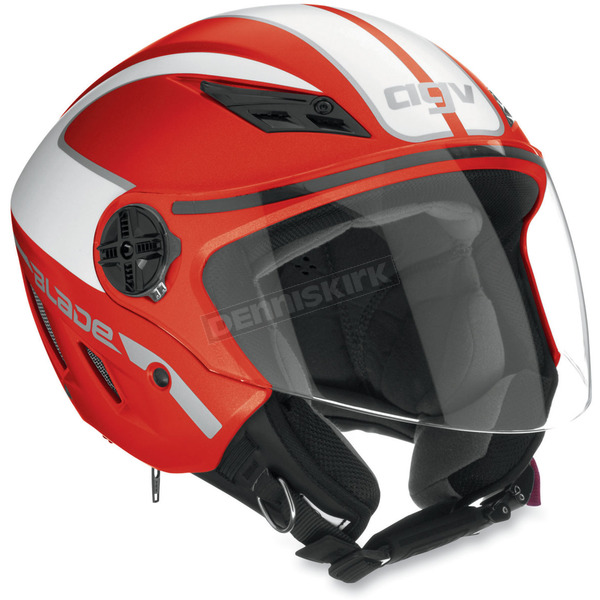

Just scored one of these hummers on close-out:
$63 plus shipping from Dennis Kirk. This helmet got a good writeup earlier this year from another member. Not full-face, but far better protection than my current bike helmet and should be quieter as it goes over the ears. Positive reviews from buyers.
EDIT: Excellent helmet, see Kingfish's review over here: http://endless-sphere.com/forums/viewtopic.php?f=4&t=23862
