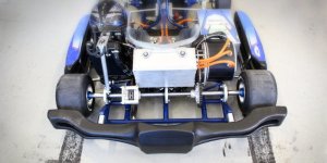

Hi guys,
I did build a E-kart with a ME1616 motor with Sevcon gen4 size 6 80V. I have 5kWh of watercooled batteries at 86.4V nominal and we can use 500A easily.

We would like support in solving our issues:
Setup information
Application: Electric kart
Motor: motenergy ME1616
Controller: Sevcon gen4 size 6 80V with fluid coolplate, see pics for HW and SW versions
Battery: powerbattery 24S2P 60Ah fluid cooled continuous 480A - peak 720A nominal 86.5V (5,2kWh)
BMS: EMUS celmodules and canbus module
Contactors: 1x at BMS with economizer and 1x at controller without economizer
Cables / busbars: 50mm2
Fusing: 500A on controller and 500A in battery pack
Dcf: find attached

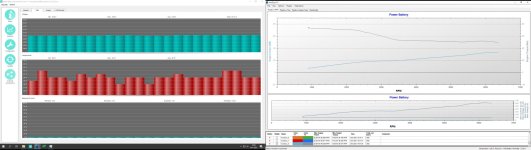

this is the 3 separate dyno graphs, and one combined. Remember these are actual measurements at the wheel, not the battery.
ME1616
18kw it basically falls flat on its face at higher rpm
zero 75-7 66V based on drbass dcf
33kW while drawing 50kW from the battery. Lower end is weak. Superflat torque, never saw that before!
zero 75-5 66V based on nuxland dcf
22kW and errattic behavior at topend so stopped the run. Lower end is better.
I made screenshots of all screens to compare values, i think I use the 33kw dcf as a baseline and try to get the lower rpm towards what the nuxland version has. Going to post this later. Already attached the 3x dcf of which are frankensteined from my own file and those of nuxland and drbass (thanks guys!) . All based on the following:

Did the comparisons. I didnt do all screens since I dont think fi contactor data does anything for power. That works, or it doesnt.
what I found:
Peak torque 120 vs 165Nm. Will increase the value.
Rated stator current 550 vs 420A Will increase the value.
Proportional gain 0.0625 vs 0.03125. No idea what that does. Will try.
Drive torque voltage cutback factor. 0.39 vs 0.99. Does this limit the torque to 39%?!?!? Trying to find out. Seems no voltage cutback set.........
I also see no reason why the high torque version has such a bad topend.

See graph: red is with me1616 motor and blue with the zero 75-7 66V
Find attached dcf (use at your own risk yada yada:)
View attachment config file 29jun21 zero 66V gen4size6 86,4V semifinal.zip
