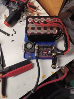

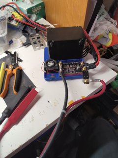

I've been blowing up and subsequently rebuilding allot of cheap spot welder PCBs over the past few months, and now I think I've got a setup that's actually pretty robust.
It's a 3s5p pack of pre production EVE 50PLs wired up to the cheap purple board you can get off Amazon for $25 CAD. I've doubled up the FETs with the backside footprints, reinforced all the traces with extra solder, added a cooling fan for the FETs, and made my own 6AWG spot welding probes with solid aluminum handles in heat shrink, with copper rivets as welding tips.
Here's a better look inside the battery
I know she ain't pretty, but the welder I used to make it wasn't great, and blew up half way through it lol!
So yeah, what have you guys done to beef up these cheap spot welding boards? Also, what's your preferred power source? Li-Po? LiFePO4? Lead Acid? Supercaps?
Lets start a show and tell.

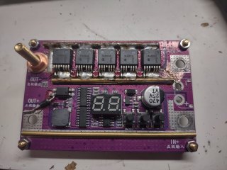

Depends on the version of the board but aren't the reasons these blow up due to bad driver design normally with maybe some failing from lack of voltage spike suppression? Adding more mosfets and beefing up traces is not going to solve those and will probably make it worse.
I don't recall about that specific purple board one but many of them have a pretty similar flaw where the the cap that is supposed to keep the circuit running isn't wired correctly and so when you fire a weld the voltage drops out which underdrives the FETs, increase their resistance and blowing them up. Adding more mosfets could make this worse as now you are trying to drive even more with less power to do so. There is a guy on youtube you shows how to fix many of them, normally you need to add or move a diode and resistor so the cap is wired correctly. Some also have other related design flaws where the FET driver circuit is just badly designed.
I think the other reason these can fail is because they have no voltage spike protection, no diodes, no TVS, nothing. So the FETs just have to take the voltage spike fed back into them and over time this causes them to fail. Easy enough to add a TVS though, on mine I also added some diodes but maybe not needed, a 5kw TVS will soak up a pretty serious spike.
Ah yes, how could I forget the first and most important mod of all, a diode and capacitor to keep the gate drive voltage up. Here's an older photo showing it in the bottom left, along with a blown up trace on the top right.
It's just a simple schotkey diode and 22uf ceramic cap that can handle the current/voltage spike without the need for an extra resistor.
As for a TVS, yeah, I probably should lol. I think what I'll do is prove it with my scope to see how bad the spike is and then get some through hole ones to bodge on lol.

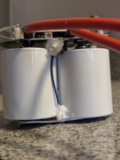

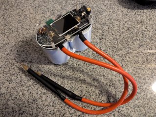

I just picked up my first spot welder from BH. Its a super cap model.
I have not got to use it yet, but my first quasi mod was adding type2 silicone to a conventional cap and jumper wires that were not very secure. Trying to avoid work hardening by small vibrations through time that might lead to failure. Granted that might not be needed but if I'm moving the unit around on the workbench and such it's an easy enough preventative action.
Next step will be building some sort of base or housing that shields the unit from fingers and dust ingress as well as protecting the components. I don't have a 3d printer yet so that's going to be tricky despite there being an existing print for this model (see link). In fact, if anyone on this thread has a 3d printer and would be willing to commission a print, I'd fork $ 😊 . Color of the print doesn't matter to me, just that it's be thermally safe filament.
