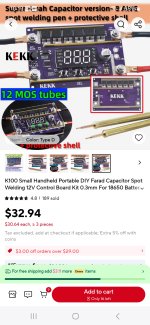

I am not affiliated with any one but I did purchase this unit. Has 12 mosfet.I have used it with a car battery to convert 10s4p&10s5p to 13s3p.1000000377.jpg

PS, I tried your welder when it first came out. They only put six MOSFET's on the front, leaving the rear empty. It was indeed very powerful, but it blew up, That's 20 bucks wasted.
It's funny they put more mosfets on them like that is going to solve any of their issues, I think these basically never fail from overcurrent spiking the mosfets. They either fail from crap fet driving design like luca has outlined or voltage spikes because they basically only use the fets internal diode to suppress those. On mine I did luca's mods and then added diodes and TVS to protect the mosfets from voltage spikes. I haven't got a chance to use it a lot but seems to work well using 3S SPIM08HP batteries. Which are cheap high current pouch cells. This is two cells in parellel it seems so twice as much as I've been using and I picked the worst cells from my lot anyway but: SPIM08HP 3.7V 16AH - Excellent Lithium Ion Power Cells Plenty of other cell options of course.
I will keep using the 13 years old Optima battery. The welder I received has all 12 but I didn't do a lot of welds&didn't get it hot
