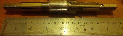

I got the axle in the post form John K - emtb/stealth
it's shorter than the old one (drop out shoulder same width) and seems like it may be made from a different metal composite because its super shiny. also the wire channel seems much more neater and maby deeper than my old one. i sent him an email to find out if its significantly different.
I bought some 50x50x3 mm square steel tube to make my hydrolic press frame. the press is a 2 tonne Nissan hydrolic jack.
it was $40, bit of a rip off but i guess raw matirial costs are increasing. it is painted black though, woop de doo, lets add $10 .

Looks to be the same design axle as the HS I replaced. The design is terrible as the wiring channel has been milled to far along. The section I have highlighted should be solid steel as that is the section which sits in the dropouts, it shouldn't be missing half the material!

He put the axle in the wrong way, and broke the new axle.
Annoying. But he will do it again for free now with a new axle.
I'm surprised he didn't think about having to flip the stator to install the new axle.
Pressing the axle end instead of the shoulder the axle sits on made it snap where the wire channel goes into the threaded section. John K didn't say much about it other than his machine might have had some movement in it to let it slip out of place or something.
