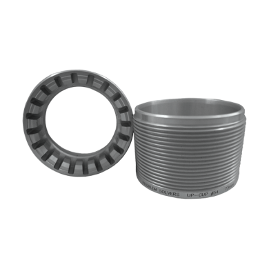

"Problem solvers" makes a variety of adapters for bicycles. There is a certain kind of bike that has a bearing cup that is made from plastic and it breaks. PS makes an aluminum replacement, about 17 threads long. The Freewheel thread of "1.37 X 24 TPI english" (as opposed to the slightly different Italian thread of a similar number) is part number CR5468.

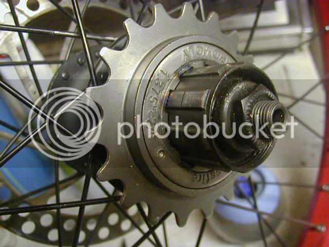

a little clarification: Any freewheel that has a reduced diameter at the reomoval tool contact points can not be "stacked-threaded" onto a feewheel.....
if you look at the dicta below, the treads are accessable from either side of the unit.
the Cross fires & Eno's would have to go on the outer most position as the threads are blocked without serious modification.
& the Eno is only a high power replacment under pedal for the trial's riders...It has a single ball bering cartrige that makes it a far poorer choice for a freewheeling crank set up....as a driven sprocket ...it is king. 2 rows of angular contact bearing make the cheaper freewheels better for free-wheeling as it were.
also, both e-tard & I have broken this set up..catostrophicly....(I went over the bars when I stripped the outer freewheel off one set up).
I still offer free broaching of the crossfires if any one wants to run 2 freewheels onto a freehub set up. JUst send me a freewheel & a package of cut-off wheels & I'll take care of ya'll.
The cup that comes with the cheap but well made "BBS 15" SunRace BB is made of steel. Use at least one on all of my bikes :p It has 15 threads.
i talk of this one: http://www.sunrace.com/en/products/detail/m90?sku=BBS15
Best thing is: You can insert BB bearing for support.

Bionicon: I cut the ASC freewheels to slip onto a free-hub
Send me a freewheel & a package of dremel cutting discs & return postage & I will hook you up.

Uh... So, Thud... could you elaborate a little on you and yours "catastrophic failures"? Cause if the outer freewheel slipped off then it sounds to me that it did so under pedal power.. Am I wrong?
V.
It was a low speed over the bars as I was pedaling between 2 parked cars in my driveway.
I stepped on the pedal & sheared the tread extension on the outer(pedal)freewheel.
I am sure it looked quite comical as it was a perfect over the bars-full tuck somersault.
luckily years of moto-crossing has me programed to fall down correctly when inevitable. :oops:
no injuries.
