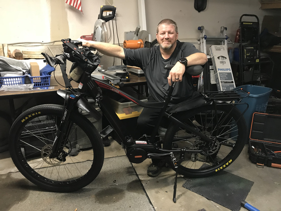

Hi Folks found this post and figured Id post. I have the same bike but I purchased mine from Biktrix in Canada. Im located in Denver. I wanted to mention that I have the Grifters on my Ultra and they do work awesome. I have the 29er wheels and hardtail with Wren front suspension.
