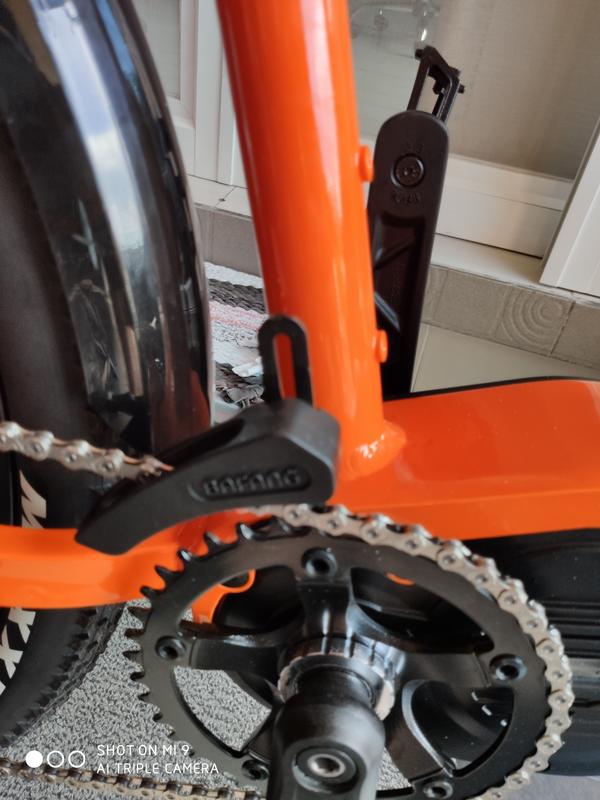

Are there supposed to be mounting holes for the chain guide? My motor doesn't seem to have anywhere to mount it.

If you didn't get it with the chainguide then you have to get the holes in there yourself. I did it as well due to too many chaindrops. But what have you been doing to your bike? Looks well used

yep, lots of chain drops, unfortunately. Ivy sent me the chain guide when she sent a new rear hub. Blew out the freewheel at the Downiville Downhill. Lots of rides in South Lake Tahoe and northern CA. I have definitely put the bike through its paces. It is a fun powerful bike!
Did you tap and die the holes for the guide? How hard is it to get the motor housing off to do that? (Or did you use some sort of self taping metal screws?) Can you send a few pics (as best you can since the chainring is in the way).
It mounted ex factory like this on my HT;

Yes, tap and die. Getting the motor off is quite easy but you have to undo the bolts and lower the motor out of the frame (you can keep it connected or disconnect as you like). Then you can tap two holes like in the attached picture and die them.
