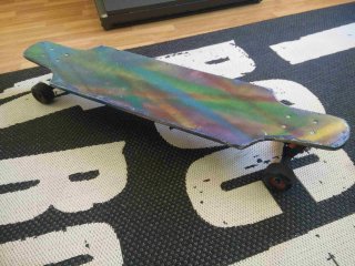

I painted the board, looks something like a star clouds/fog, then applied the cloth and epoxy coating.
No griptape. Hoping that mailman delivers it soon.

I painted the enclosures, sealed them and bolted on board. I added a superglue to the bolts, so they are solid part of the board now. Now all i need to open the enclosures are few nuts.
Allright! Now it is rideable.
The welding was perfect. I painted it afterwards:
