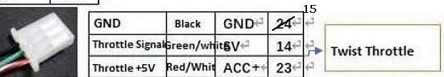

Ah! I remember: for me (only) it was: the Fardriver wanted the throttle wires as different connection than the stock controller did.
Fardriver wants:
- the red-white wire (pin 23) > I had to connect to "Throttle +5V" (I call it that, but yes, "The high throttle threshold of an electric motorcycle handlebar (which has a full throttle of 4.1-4.3V) will be set to 3.9V." (which is a straight quote from the Chinese Fardriver Manual, translated by myself into English)
- the green-white wire (pin 14) > I had to connect to "Throttle signal" - despite that the manual's image says the opposite!?!? :oop:
- and the black wire (which actually is pin 15 in my loom, not 24, I found out via continuity measurement) > I (only I??) had to connect to "throttle GND". Again: For as long as I used for "Throttle GND" the 12V wiring on my bike, "self-learning" failed. Only when I used for "Throttle GND" the actual pin 15 wire from Fardriver, "self learning" worked. :oop:
I would have thought GND is GND, like red is red, and like a lemon is sour. But no. :LOL:
Frankly, I (electrician) have yet to figure out why Fardriver needs specific wiring in some instances, but here is still "rain period" and I can only open up the foot deck when it's not raining/dry (I don't have a garage).
Once we get better weather, I should be able to give you more detail on all wiring needs. Then again, I don't know if all sold Fardrivers are the same in terms of wiring?? :unsure:

Thanks for that,i do not think it is wiring, had it auto learn set about a year or so no problem,
this time with new app it beeps to say auto learn,i twist the trottle and it spins the wheel one way and stops.sometimes it starts auto learn in reverse and stops, wait no joy i let go of trottle and it starts the auto learn beeps again?
