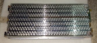

Converting my old hydrostatic Craftsman mower to electric. I am using a Motenergy ME-1004 motor. I got a couple battery packs from a model S Tesla. No controller, just a contactor. I have a chepo ah meter on the way. Trying to figure out the best way to mount them. Can I mount them flat, layed atop the motor with enough clearance for airflow, or are they designed to be layed vertically, on their narrow side? They are pretty heavy and am not sure how they were designed to be mounted in the first place. The long narrow sides have a flat surface that I could mount them with I think. But only one side has holes. Also, do any of you know where I would put balance leads on these? Thanks
