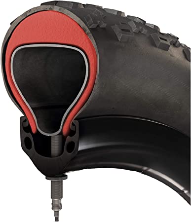

Tannus Armour liners plus sealant in the tube.
to me looks like a great option.
