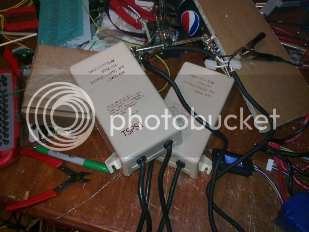

thaaaaaaaaaaaaaat sucks. Maybe now is a good time to try out bulk charging...? I got a genuine s-150-27 meanwell off ebay for $20 shipped... shipped from california.... only 5.7a but works well.... I use two in series for charging my 48v ping.... cheap and simple.
Maybe...I might have a 24V-ish power adapter somewhere....hmmmm.
I already put in warranty claim with EPBuddy, so hopefully I'll have a replacement soon, but it would be nice to not be reliant on a single charger.

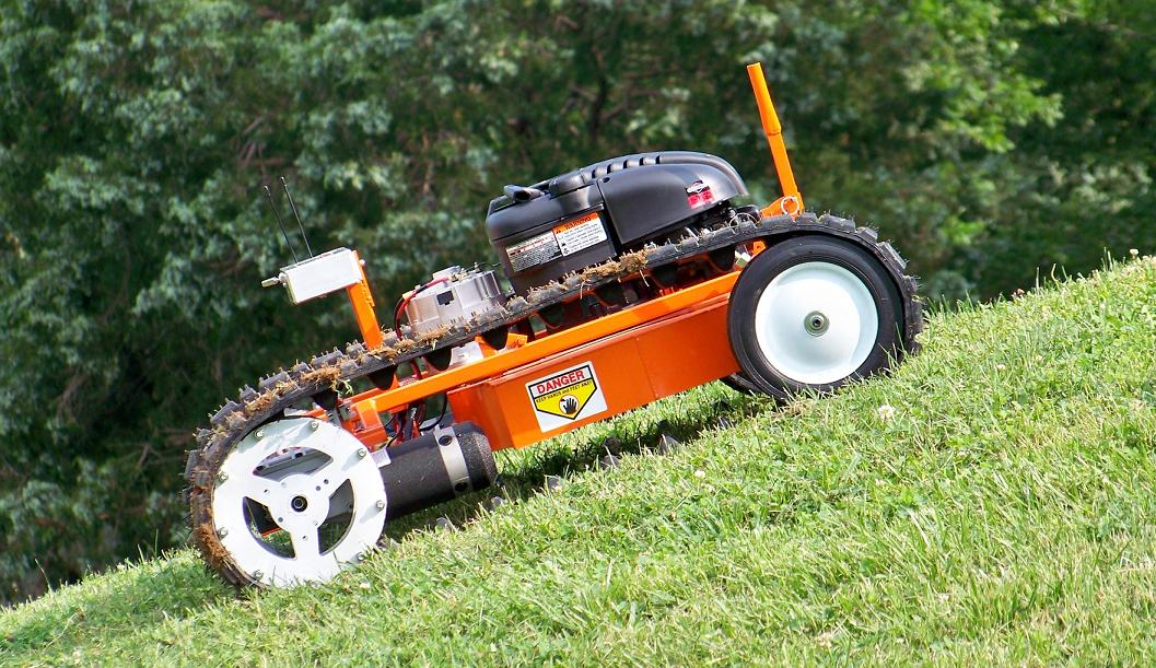

If you like bad ass radio controlled lawnmowers, you need to see a movie called Frankenhooker some day. The nerd has his new robot mower go bad and chew up his fiancee in the opening scene. Then he starts trying to rebuild her but needs parts.
dogman said:
Interesting that you saw sagging in thick grass. Perhaps 7s is the best for big jobs. I found 8s made a pretty scary blade speed. I just wasn't sure how fast really, and have seen some rocks and such fly out of mowers pretty hard. Maybe try 6s and have some 2s boost packs when needed?
I'm not sure if it's sagging or just the blade bogging down, tbh. All I know is that the blade slows down in thick grass. Now, first a disclaimer; because my charger blew up last night (EPBuddy actually responded at 12:30am EST....color me impressed :D ...now I just have to find a printer...) and the easiest charging method I was able to cobble together was a couple really old 24V 0.35A bricks in parallel (0.7A charging! Hells yeah! :p)...which actually only run at 23.5V...I was only able to get my packs up to 23.5V, or 3.9V/cell. As a result, I haven't actually seen how it will behave in the upper 50% of the 80% capacity that we use, but from the bottom 50%, I'm going to say that 7S would definitely be a good idea for this mower at least. IIRC, Homelite says this is just a 400W motor, and if that is correct, I'm pretty impressed with its grunt so far. It is noticeably less powerful than my 22" Lawn-boy with a 4.5HP Briggs & Stratton engine, but for ~12% of the rated power, I would expect so. Unfortunately, I don't have a CA/WattsUp/etc, so I can't say what power it's pulling exactly. My multimeter does have a current meter mode, but it tops out at 10A...so that wouldn't be much use. It looks like Harbor Freight has a cheap clamp ammeter for $13 though, so I might swing by and pick up one of those tomorrow. Going from 3.9V to 3.5V (yeah, I know; there was a last little bit that I wanted to finish after I noticed that it had hit 3.6V :p ) with a 15Ah it did about 1/32 of an acre, but about a quarter of the time it was running I was doing stuff around a row of small trees, and the rest of the time it was going through very thick grass, about 18" tall. I'll update tomorrow on how much it can do without the messing around with the trees. I'm guessing, though, that once I can charge them to 4.2V/cell again and once I get through the really tall stuff and am only cutting off a couple inches, a 15Ah pack might just take care of the part of my back yard with grass (a little over 1/2 acre, I think).
Anyways, my recommendation for this specific mower is that it's fine for home use, seems to do just fine on normal grass with 6S LiPo, for thick grass would really benefit from a 1S or 2S booster pack. I would definitely not recommend it for professional use though, partly because of the small motor, partly because of the 20" cut size, and partly because the blade they use is very thin; presumably to make it easier for the small motor to spin it easily. I think that 1.5kW motor referenced earlier, though, running a 22" or 24" deck would work great.
Or better yet, a couple real ones. :mrgreen:
http://hackaday.com/2009/11/14/rc-lawnmower/
http://hackaday.com/2010/05/03/remote-control-reel-mower/
Hahahaha, wooow. So, I had those old power bricks hooked up, bulk-charging my pack, and I smelled a burning plastic smell...turns out these brick enclosures were made with a much lower temperature plastic than modern stuff, and the two sitting on top of each other had started to melt the plastic in between. They actually stuck together when I took the top brick off. :lol: I wouldn't have thought two transformers only pulling 30W each would make that much heat, but I guess I was overestimating these old parts. :p
Hahaha, I know. They put out 24V@0.35A and 5V@0.60A. A while ago I picked up a box of random old electronics off eBay for parts scavenging ($20 for, iirc, ~20lb of stuff). They were in the box. :p Some of the other stuff in the box that I actually recognized were old programming cards from 70's-era mainframes, so I have no clue how old these are. I actually got three of them in the box but one of them isn't working. Looks like it might just be a blown capacitor but I haven't tried fixing it yet. The pack just now hit 23.5V, so that was what, about 6 hours to put in..should be 8Ah if my calculations are correct (3.5V/cell to 3.9V/cell on a 15Ah pack)? So it looks like they power supplies are putting out almost twice their rated current levels...maybe because I'm not loading the 5V line...no wonder they're getting hot. :lol:
