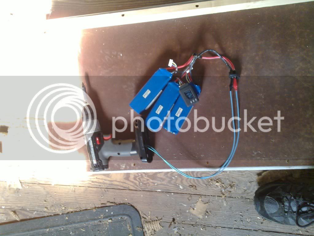

Heheh, so, not exactly on the topic of lawnmowers, but in the theme of 'lipo; not just for toys', I did this today and thought someone might enjoy it. :mrgreen:
Runs a lot stronger than on the normal NiCad pack (which was dead), but I need a more reliable connection. Those alligator clips don't stay on either connection very well...

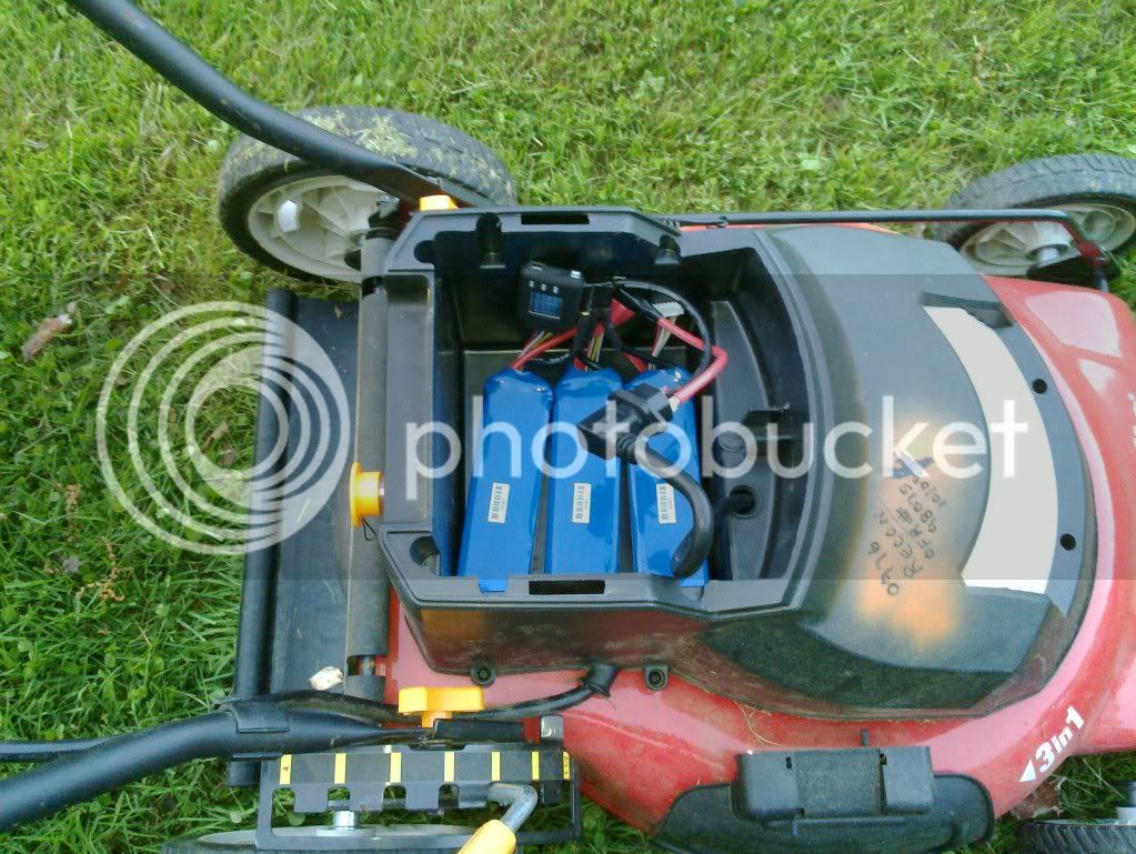

Oh, and while I'm posting pictures, a bit more on topic, here's my mower with the LiPo pack. :D

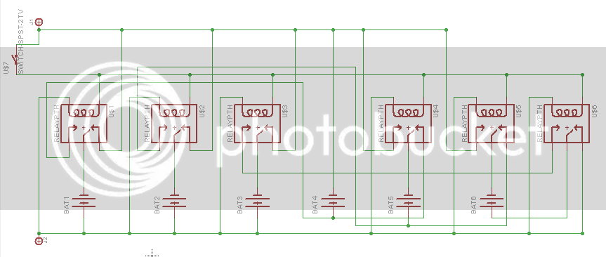

Ok, I had more caffeine so I got the energy to try my hand at figuring out Eagle (been up since 9:30 last night and been doing lots of physical labor today). I'm not sure I'm really using it right...and not being able to make or easily find exactly the part I wanted (like, say, a 6S battery symbol) is annoying...as is it not automatically putting in non-intersection notation for the leads that seem to cross in the schematic... -_^ So instead of going through the much longer and fiddlier process of manually making the notation, I just specified all the junctions. Not that way I would have liked to do it, and maybe there is a way to make it do it, idk. Anyways, here's my first rough draft of the circuit. Oh, also, I can't figure out how to modify the labels... :x
The socket at the top left is the pack +, the socket at the bottom left is the pack -, batteries 1-3 are 6S, and batteries 4-6 are 2S. Everything else should be self-explanatory.
Normally it sits at a 6S4P config but when the switch is closed it reconfigures itself into an 8S3P config. This is sort of a primitive but cheap (I priced out 30A rated components to ~$30 new or ~$20 using 25A surplus parts), durable, and simple 2-speed throttle to let me boost the speed of the blade if I hit a really thick/tall patch.

I have the 24v B&D battery mower. It's not all that powerfull compared to a very similar mower in the same brand, that plugs in. With the original SLA's it did not perform for very long either. I now run the battery mower on lipo batteries, and it has enough power to mow my lawn good enogh. I do have to cut twice if it's very tall though. One pass set tall, then another at the lowest setting.
Though definitely not as powerfull as a 110v corded mower, or a 3.5 hp gas, it is good enough once you ditch the crappy sla batteries. Using 6s lipo, with three bricks of it paralell connected, I have 15 ah of solid battery that doesn't sag when I hit the thick stuff. Occasionally the mower may shut off when mowing hard, when a thermal sensor trips in the motor. So if that happens it's time to raise the mower a notch, and mow taller.
