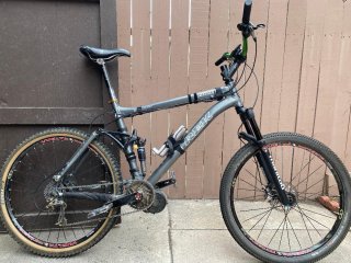

It's possible to build lighter. My FS off road Trek with BBS02 is <40 pounds (less battery), so 43 or so when I use a 52V, 4 ah for a 10 - 15 mile ride. The errand bike (a bit blingy) is about the same even with an 18 pound rear wheel).

What year/ model is the FS Trek?

Are those both small-framed 26" bikes?

2006 EX (8 or 9 AIR; it was the last year they were made in the US so I grabbed in 2006 or 7). The major changes were fork and wheelset, but probably some cockpit ones over the years too.

The Trek is L/XL, but you're right, the Specialized is S and both are 26". I don't fit great on the blue bike, but it's not a big deal since the pedaling platform isn't bad.
