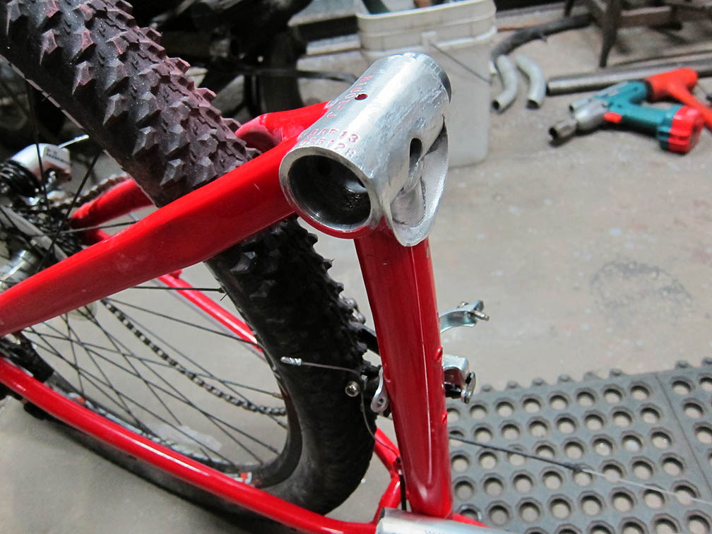

Gary brought by his donor Diamond back and like with all the best bike mods this started with a sawsall. :lol:
The idea here was to replace the downtube with twin tubes like a MX motorcycle frame. I'd connect to the front at the headtube, and run the rear down to the bottom bracket moving the connection slightly forward to make room for the motor. Since I was using only 6011 T6 aluminum and MIG welding it (lower heat exchange) I could weld it up without blowing the temper or having to heat treat it afterwards. The first thing was to get the forward transition to look right, which meant I had to bend the tubes. T6 can't be bent cold untreated you have to heat it to temporarily remove the temper. I always do this on the stove. You start by marking the tubes with a black marker then heat them.

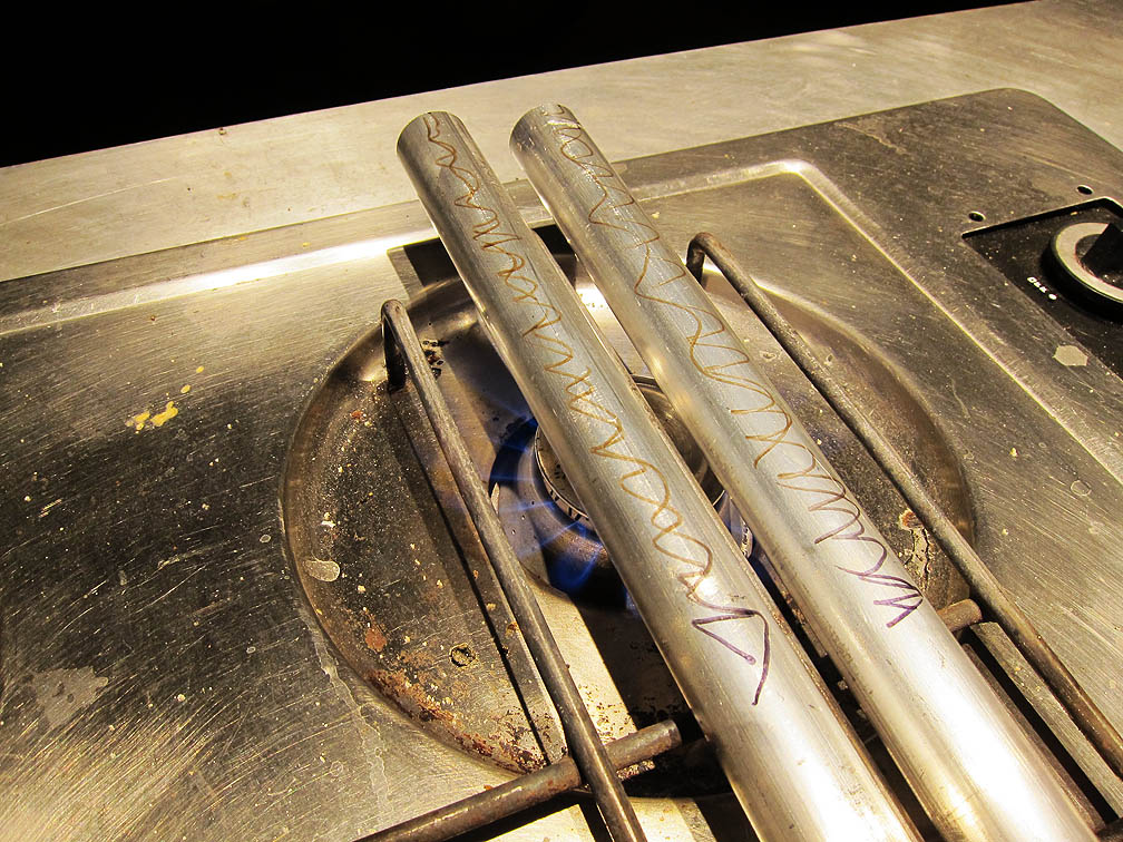

When the black marker has transitions from dark to brownish gold. That metal is 350+ or temporarily T4 (it re-hardens with time) so it's ready to bend. This is the oldest trick in the book, but I still think it's cool every time I do it. 8)

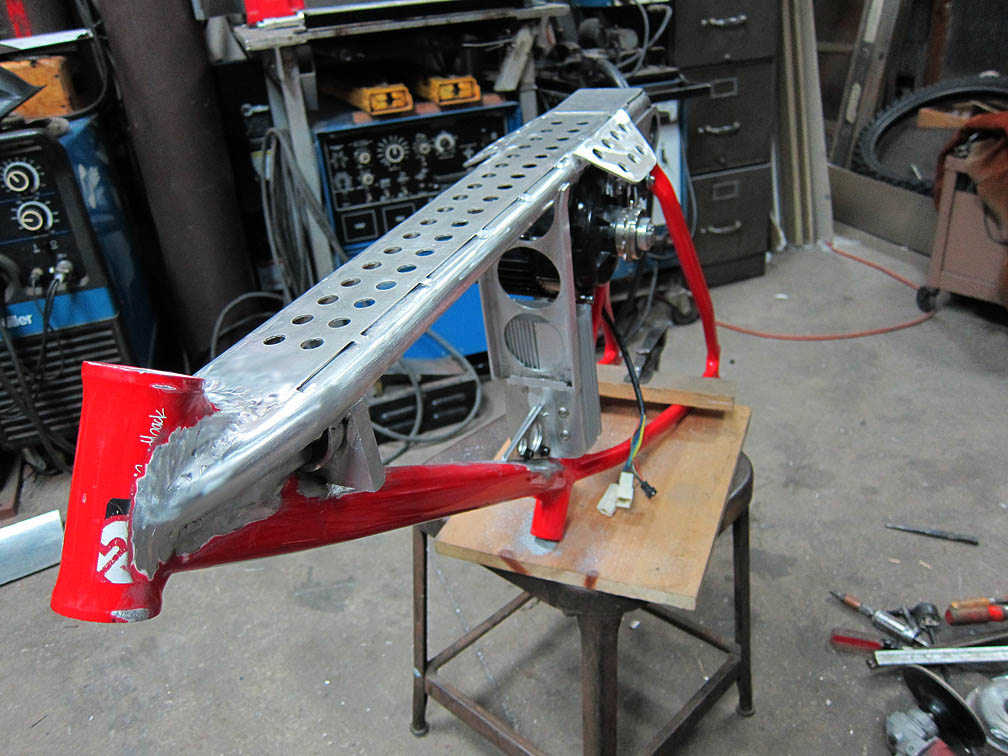

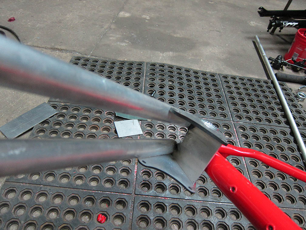

So I threw that metal in my bender, put a radius in it then cut the ends to make a even transition to the head tube.
Once that was fitted I cleaned up the bottom bracket and then welded the tubes to the front of it then added additional bracing.

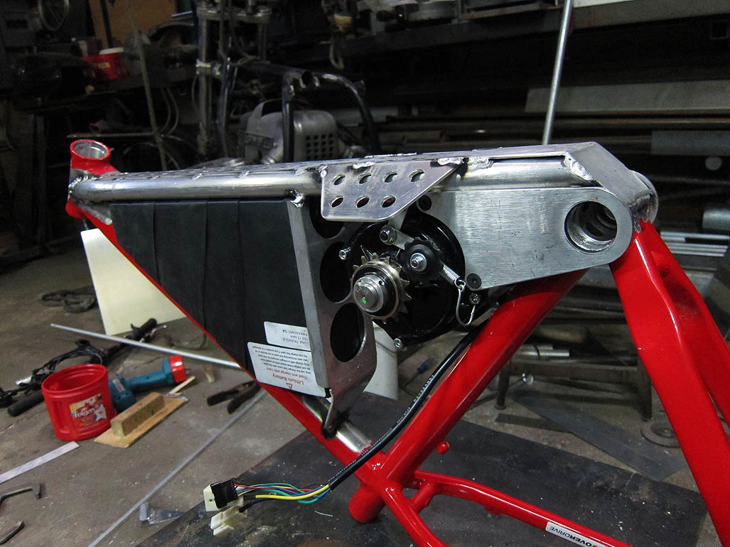

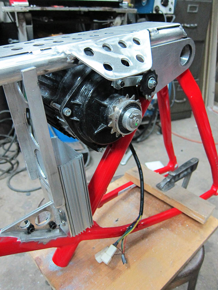

Here you can see the added back plate stiffener for the motor mounts.
I considered making my own motor mounts but used theirs out of expediency. As you can see I beefed them up a bit.
With the added bash plates you can see where this is going.
So that is the basic frame, weighing in at mighty 6 pounds.

Next step was to add the side bash plates to protect the motor and my initial try at a battery mount.
The idea there was the battery would twist in and out and be held by a removable bracket in the front. Unfortunately the battery got stuck. While fighting with it I decided I wanted to cover the battery with metal to protect it anyway so that mount was scrapped though the bash plates remain.

Now I needed a way to hold the battery in place, so I modified the first bracket I made.
Chain ring side bash plate, rear battery support, and controller position.

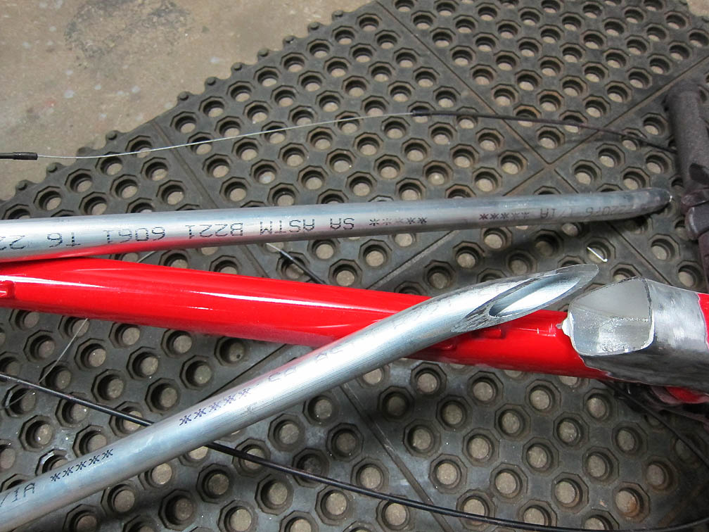

Part 1 Aluminum.

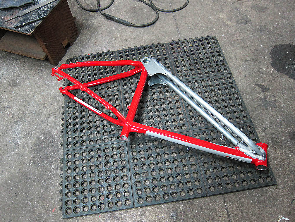

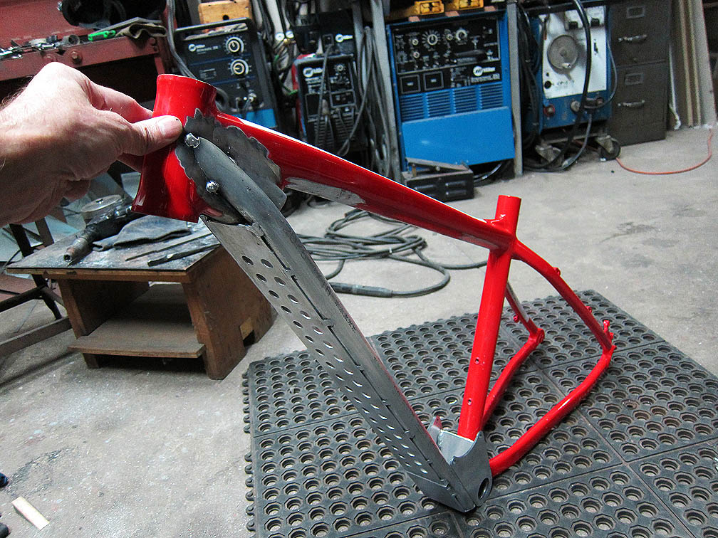

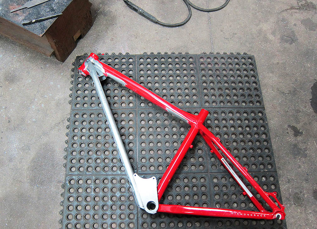

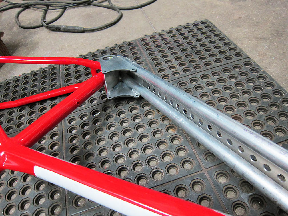

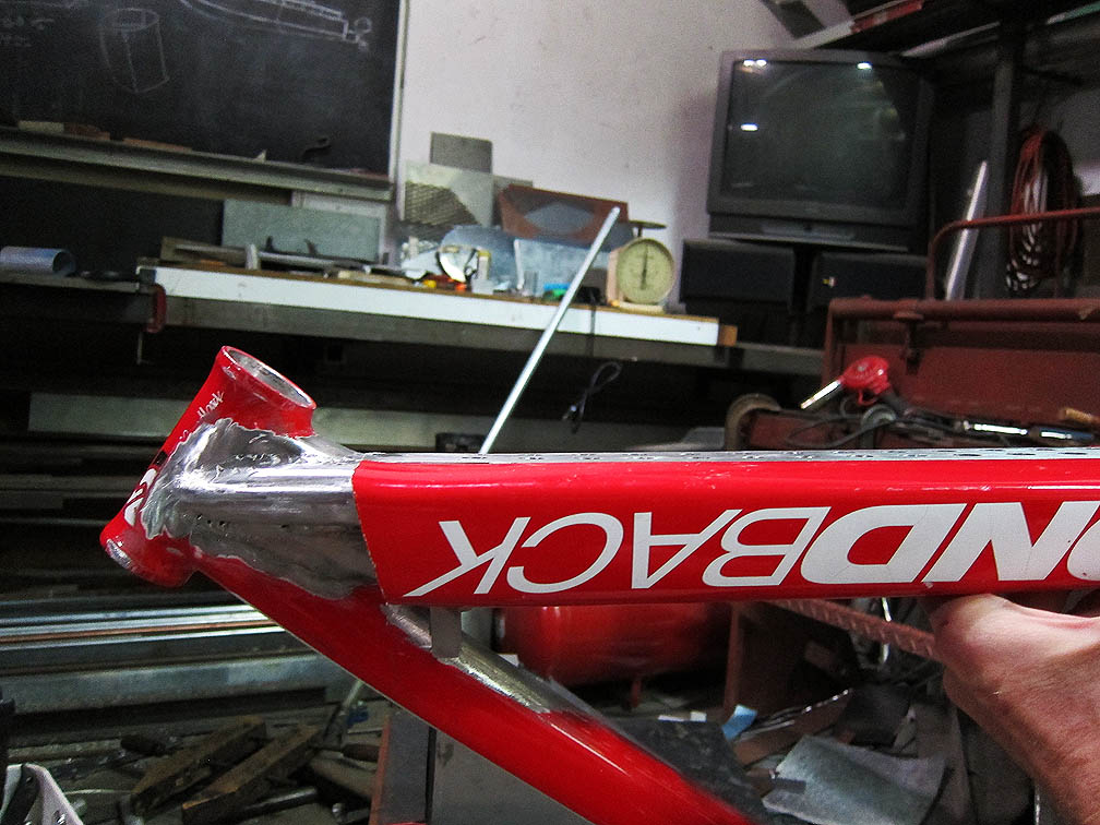

![vhCOurB.jpg](/sphere/proxy.php?image=http%3A%2F%2Fi.imgur.com%2FvhCOurB.jpg&hash=41967861dbcbea3c2a950fc6fa10fd05)
![Tqs44B1.jpg](/sphere/proxy.php?image=http%3A%2F%2Fi.imgur.com%2FTqs44B1.jpg&hash=87a7959921df42d8dce514d6db85321c)
![xB7km01.jpg](/sphere/proxy.php?image=http%3A%2F%2Fi.imgur.com%2FxB7km01.jpg&hash=7c6081f96b89367fcdc898bbdc04bd0f)
![7dQGk7K.jpg](/sphere/proxy.php?image=http%3A%2F%2Fi.imgur.com%2F7dQGk7K.jpg&hash=3b3c352f9e9fc65277d40591984fa966)

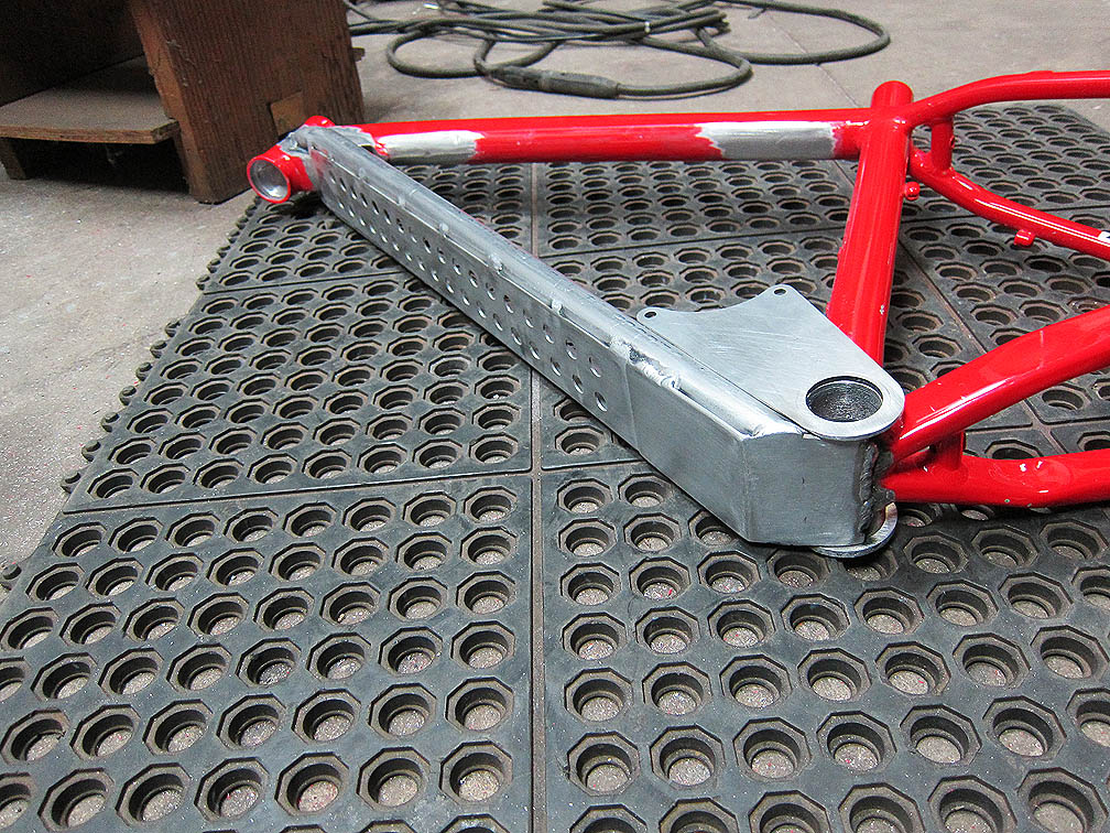

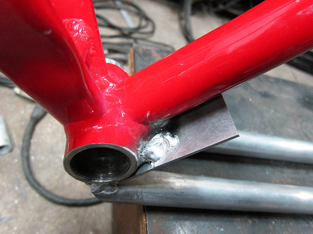

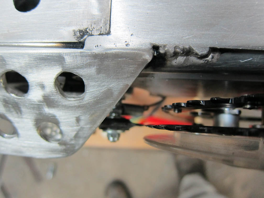

![njHn7zN.jpg](/sphere/proxy.php?image=http%3A%2F%2Fi.imgur.com%2FnjHn7zN.jpg&hash=604c2f211cf5fdeb86659757eaf912df)
![sm4q4zf.jpg](/sphere/proxy.php?image=http%3A%2F%2Fi.imgur.com%2Fsm4q4zf.jpg&hash=b507ed9336530a686f48783e8202e6c1)
![DMEyvcR.jpg](/sphere/proxy.php?image=http%3A%2F%2Fi.imgur.com%2FDMEyvcR.jpg&hash=e0df136660b46ff124d091faf0bbfd08)

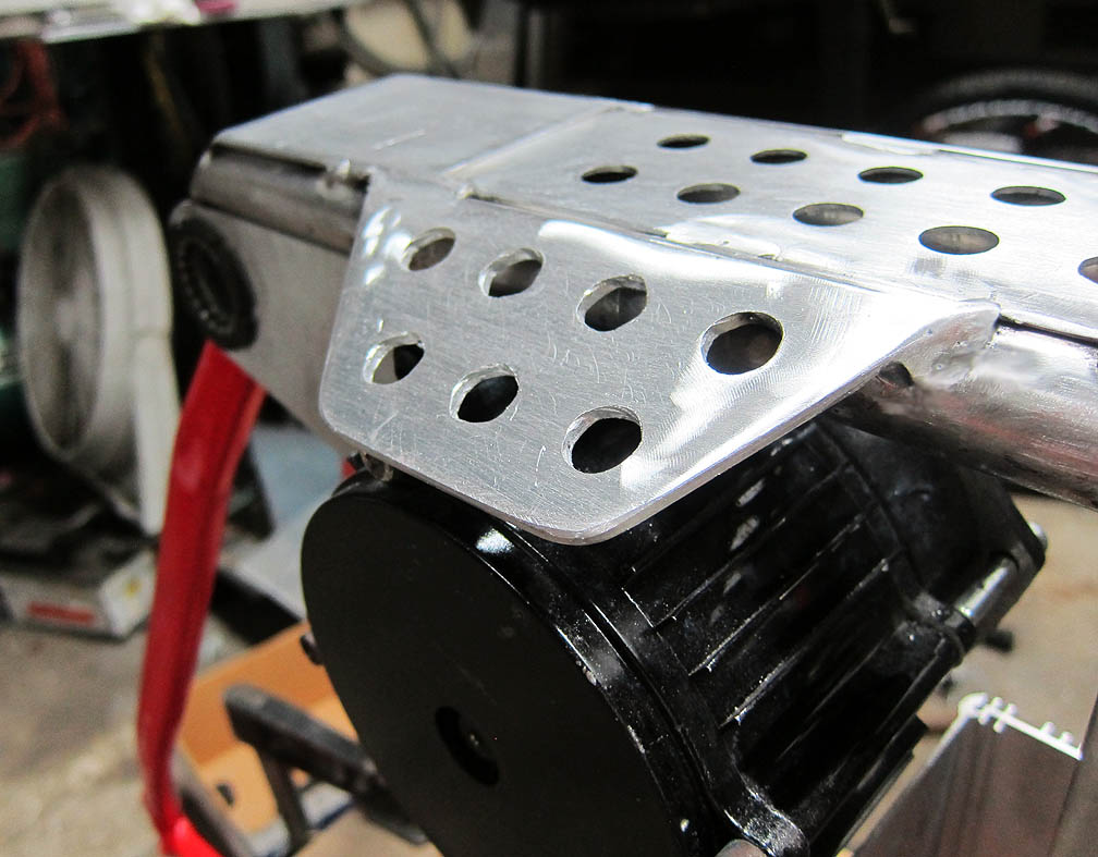

![ECfmgwp.jpg](/sphere/proxy.php?image=http%3A%2F%2Fi.imgur.com%2FECfmgwp.jpg&hash=79c5e30db123930c2c28b60caadab136)
![H1aeqWL.jpg](/sphere/proxy.php?image=http%3A%2F%2Fi.imgur.com%2FH1aeqWL.jpg&hash=217149693586a000f5affdec81249269)
![BO8myOe.jpg](/sphere/proxy.php?image=http%3A%2F%2Fi.imgur.com%2FBO8myOe.jpg&hash=87ed01ad81524f9ebbd5e05152998e96)
![roz9HoP.jpg](/sphere/proxy.php?image=http%3A%2F%2Fi.imgur.com%2Froz9HoP.jpg&hash=748392c972a2880e0d1257963a296426)
![iPj0IWr.jpg](/sphere/proxy.php?image=http%3A%2F%2Fi.imgur.com%2FiPj0IWr.jpg&hash=491fc9a74179552f7c27202780b3d633)
![6ICfQ8t.jpg](/sphere/proxy.php?image=http%3A%2F%2Fi.imgur.com%2F6ICfQ8t.jpg&hash=f7ef0386a1019539a942cfe8d34bfb7a)
![CW49mXF.jpg](/sphere/proxy.php?image=http%3A%2F%2Fi.imgur.com%2FCW49mXF.jpg&hash=6e844a747a6ffe3421883de6d43c6e21)
![VWUpqgo.jpg](/sphere/proxy.php?image=http%3A%2F%2Fi.imgur.com%2FVWUpqgo.jpg&hash=79fb5ec2d2df65c1c8feb9f2494ccda3)

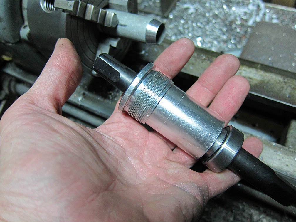

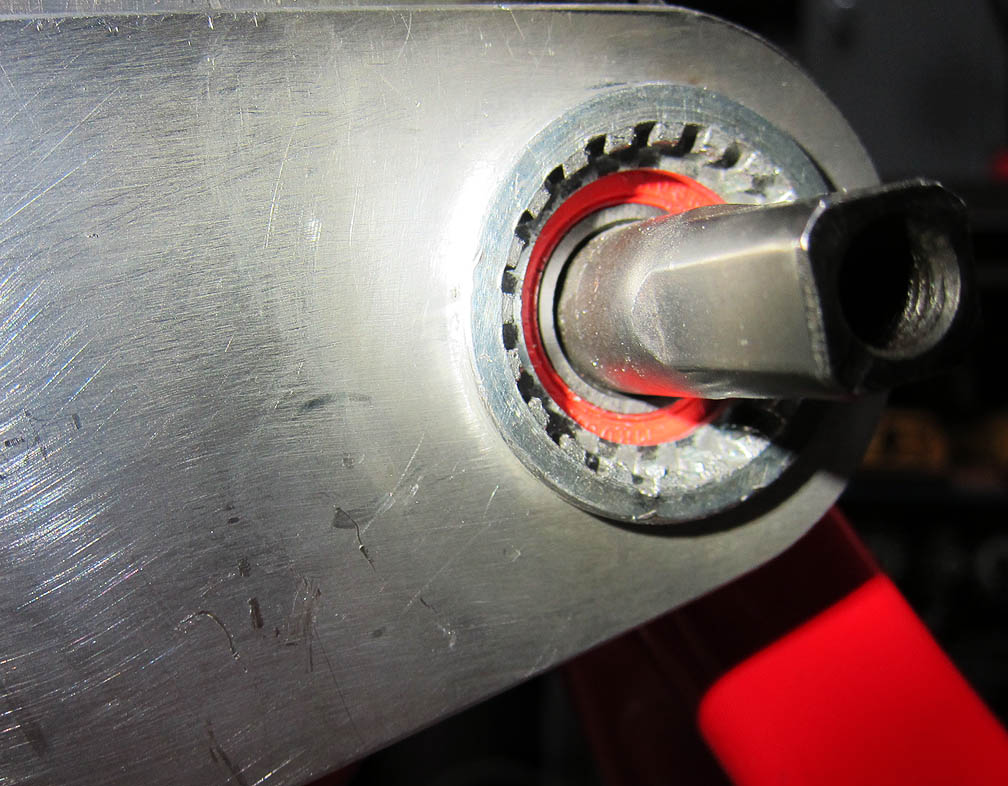

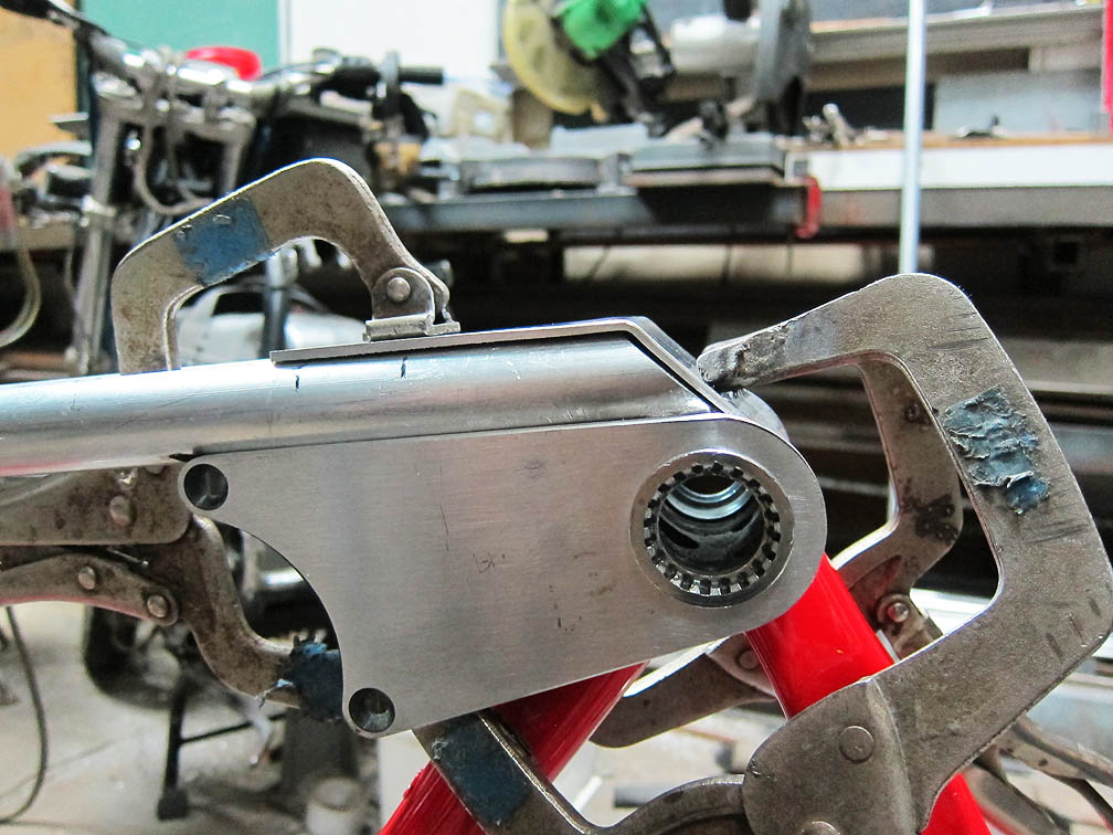

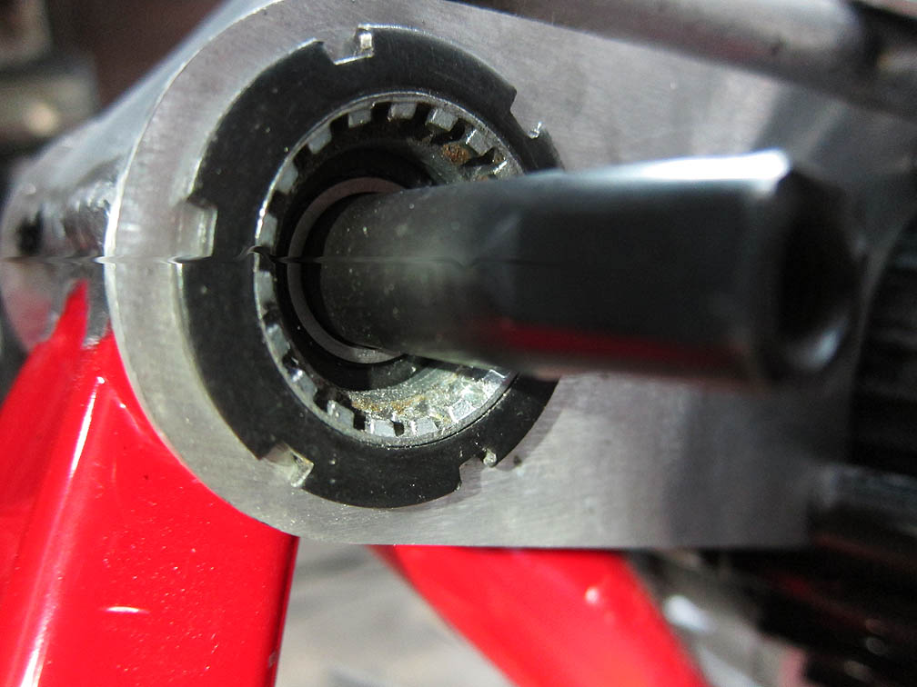

Part 3 the war of the bottom bracket.
I hate to bash people's stuff, but I'll be straight up I had some real problems with the standard cyclone kits ]replacement tapered 68-83mm BB. The right side tried to cross thread every single time I attempted put it in. Both cups were shallow and the left cup was also not deep enough to correctly catch the bearing, and the bearing spacing was not correct to line up the crank arms properly with the motor. Just not cool. The first mod I made was a bearing spacer to get the bearing over.
![GTuvQCc.jpg](/sphere/proxy.php?image=http%3A%2F%2Fi.imgur.com%2FGTuvQCc.jpg&hash=77a5d7376bf8bd8e1aba15804692ad1f)
Even with the bearing moved over the cup still would not thread. After fighting with it the better part of a afternoon, and re-cutting the threads with a die, I gave up and threw a pair of used Shimano cups on the lathe and machined them to the exact tolerances I needed.
![OQiM8YP.jpg](/sphere/proxy.php?image=http%3A%2F%2Fi.imgur.com%2FOQiM8YP.jpg&hash=80c1bb40999b538867b2bc2b4676ecd7)
That threaded up nice fine but once in place I realized the right cyclone kit bearing was bad. It had a bind or catch in it, so I took the whole thing back apart and replaced the right bearing with a Shimano sealed bearing of the same size.
![Am9m8OM.jpg](/sphere/proxy.php?image=http%3A%2F%2Fi.imgur.com%2FAm9m8OM.jpg&hash=1b194187325850bc44d961318bd08def)
All Shimano goodness right there.
Since the right side gets the most force and the left bearing seemed fine I just used the left bearing that came with the BB on that side. Hopefully that won't come back to haunt me.
![WxiCrEX.jpg](/sphere/proxy.php?image=http%3A%2F%2Fi.imgur.com%2FWxiCrEX.jpg&hash=b545e903ed5824a0d086a2e602a17f43)

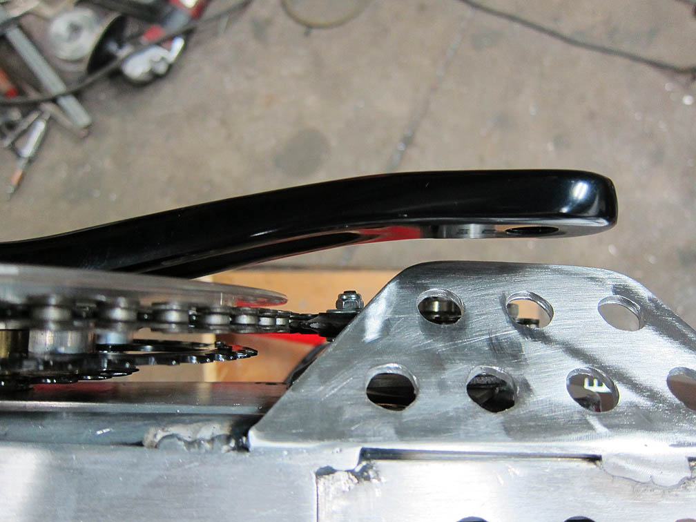

This got me the exact alignment I needed one the crank and drive chain rings.
![auh2uMa.jpg](/sphere/proxy.php?image=http%3A%2F%2Fi.imgur.com%2Fauh2uMa.jpg&hash=6f4a78775b582b65abda8594ab0621df)
The crank arms had the proper spacing as well.
![DJDAX4m.jpg](/sphere/proxy.php?image=http%3A%2F%2Fi.imgur.com%2FDJDAX4m.jpg&hash=cbb6592b62e42b7f8d3d8519679f37d7)
![SBeI6ln.jpg](/sphere/proxy.php?image=http%3A%2F%2Fi.imgur.com%2FSBeI6ln.jpg&hash=e550268e591f595e74ebf2cfdc485561)

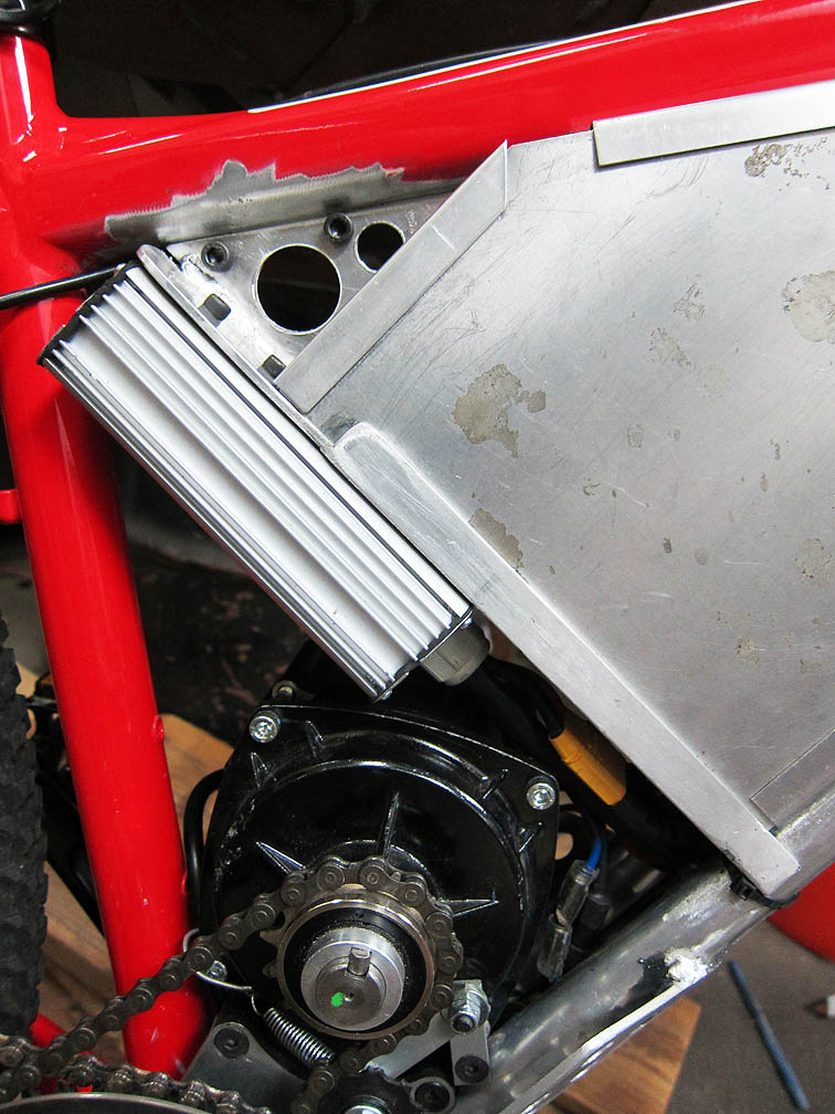

Part 4 General refinements and the battery and controller mounts.

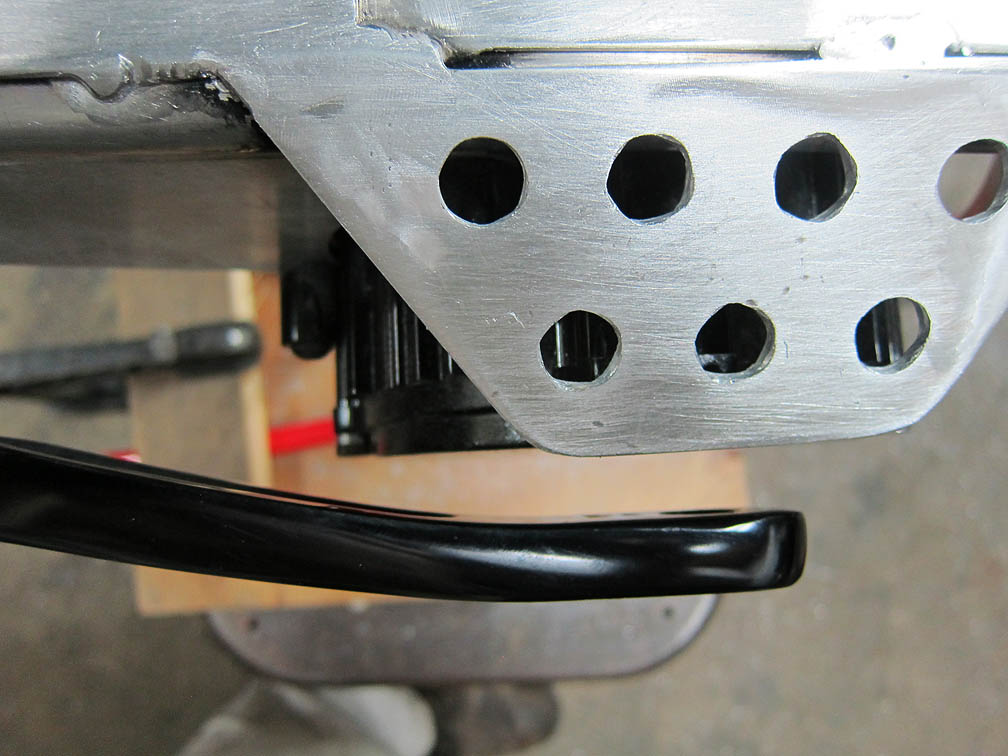

![2GuCj68.jpg](/sphere/proxy.php?image=http%3A%2F%2Fi.imgur.com%2F2GuCj68.jpg&hash=7a2a7a6acdcf08ac2e3b7fd6bac56578)
![fDQAUiI.jpg](/sphere/proxy.php?image=http%3A%2F%2Fi.imgur.com%2FfDQAUiI.jpg&hash=d2a7789427b11bc25b78c2b6032d31f1)

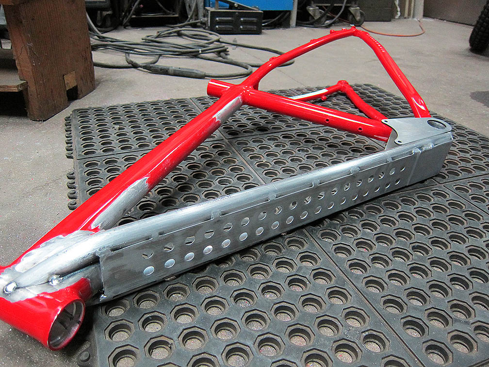

Down tube Bash plate right side full length.
![6pAZdhw.jpg](/sphere/proxy.php?image=http%3A%2F%2Fi.imgur.com%2F6pAZdhw.jpg&hash=88194f2424e750b96741e3f6167eed6a)
Motor bash plate left side.
![JWNNAD7.jpg](/sphere/proxy.php?image=http%3A%2F%2Fi.imgur.com%2FJWNNAD7.jpg&hash=4cdf27d6b6c0e17a9d4409934be5bc93)
Bash plate and down tube left (note the opening for power cable routeing in front of the forward battery stop, all wires from the front will run under the battery.)

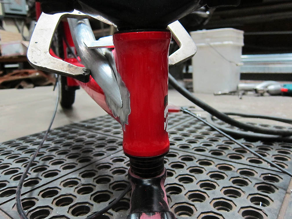

Here you can see how the twin tubes line up compared to the original.
![opq0sho.jpg](/sphere/proxy.php?image=http%3A%2F%2Fi.imgur.com%2Fopq0sho.jpg&hash=439f795290ce4ac6dae53b9796199df6)

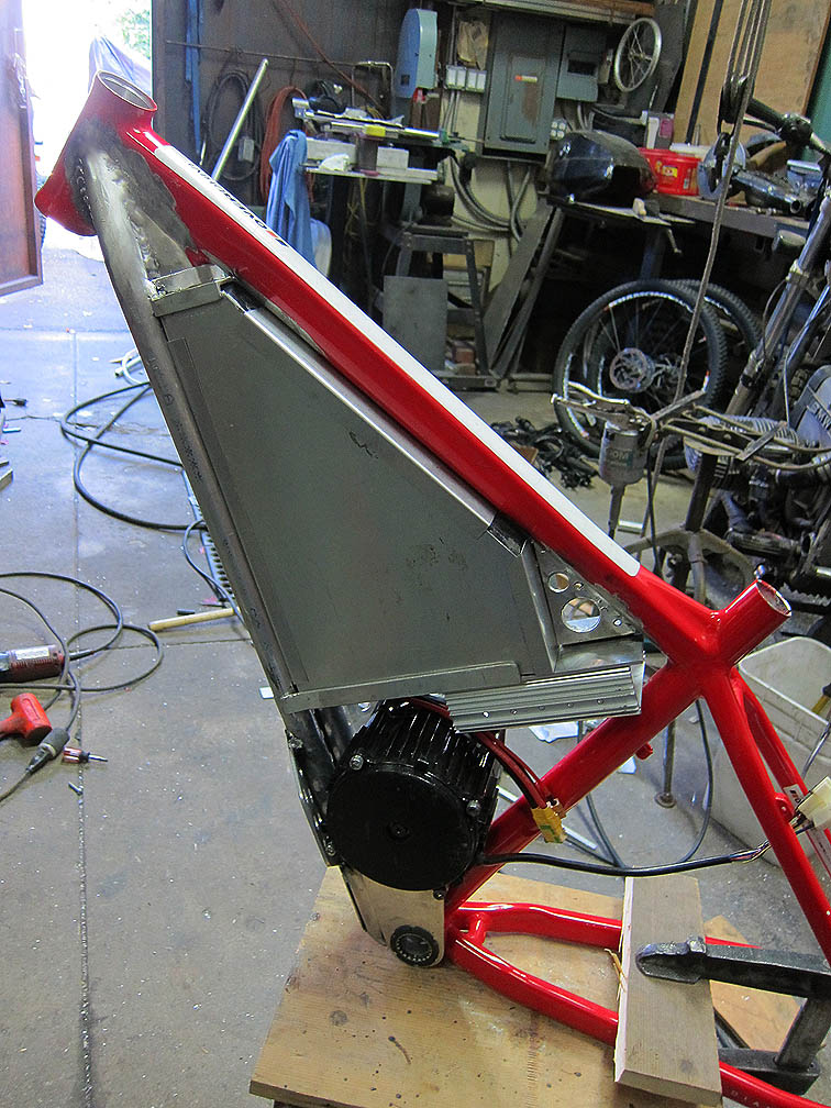

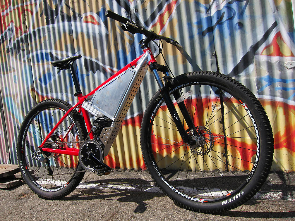

Here's the battery position with my initial enclosure (there are still some minor refinements I'll be doing to the enclosure)
![B0hUroq.jpg](/sphere/proxy.php?image=http%3A%2F%2Fi.imgur.com%2FB0hUroq.jpg&hash=07412babb62b5f8ad22074bcdfee8da0)
As you can see the down tube has been converted twin arm motocross type to give him more protection but also more space for the battery and motor. It also allows space under the battery for routing excess wiring. Best of all it keeps the frames original size with the profile of the frame the remaining same. (stealth factor) The new structure connects at the two fixed (non flexible) points of the frame, but leaves the rest of the frame to flex under load like a normal frame. So the bike itself still feels like a normal bike even with it's gear and power load.

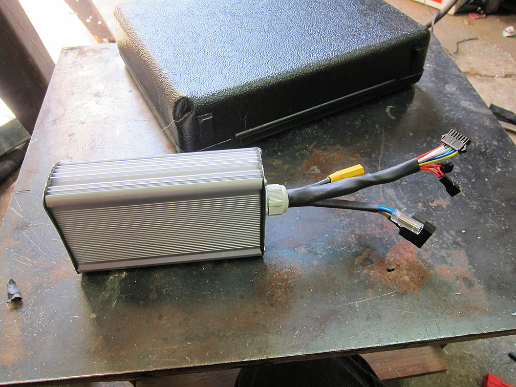

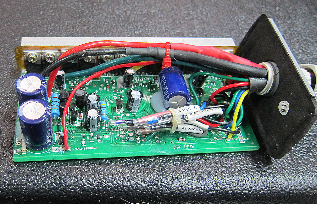

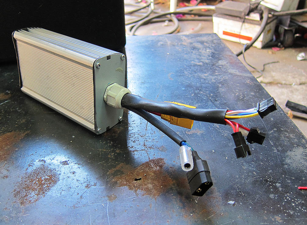

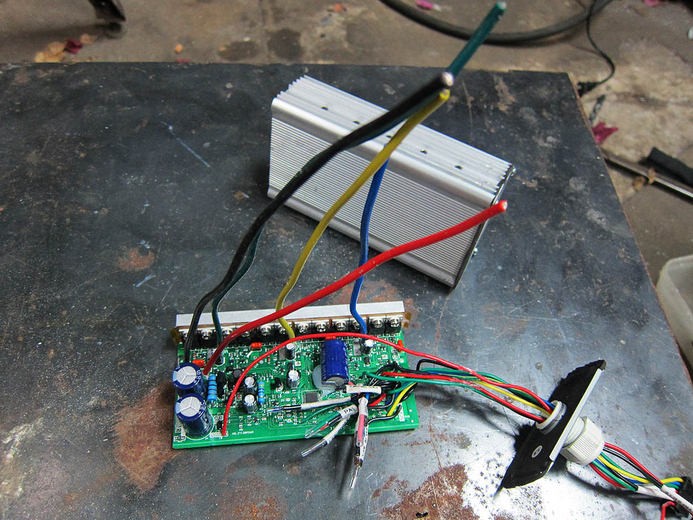

Part 6 Wiring the controller.
So I could not find much information about wiring the controller, but gave it a hard look over and basically figured out what I needed. I kinda decided to remove everything else, but then was afraid to do it :lol:
Friday after a long night I took the plunge. I cut off all the wires that I did not need, and heat shrinked them clear with their respective labels inside the controller for further reference.
![IwNxfQG.jpg](/sphere/proxy.php?image=http%3A%2F%2Fi.imgur.com%2FIwNxfQG.jpg&hash=b477989dd86f4eea02d4e51c020d9a51)
I then spliced in a new power feed wire for one of the connectors so I could solder it in inside the box.
![Cvq2qZ8.jpg](/sphere/proxy.php?image=http%3A%2F%2Fi.imgur.com%2FCvq2qZ8.jpg&hash=2991f8835e90ba005b794f7409865321)
Connected that wire in when I wired the new power leads, with XT90 connectors.
![stJJOJc.jpg](/sphere/proxy.php?image=http%3A%2F%2Fi.imgur.com%2FstJJOJc.jpg&hash=71598564d397adf6126872edee35214e)
