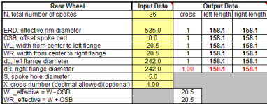

Here are my calculations using the sheldon brown program and a mavic EX721 with an ERD of 535. 158mm spokes for a single cross.

I could not see a measurement for the spoke hole diameter dimension for spoke length calculations in your pictures
i saw this from Andje, but would like confirmation first before i go and order spokes based on just one measurement.
file.php
Could you check the spoke hole diameter for us, so i can at least get my spokes length calculated and ordered
Neil

And my measurements where based off of using sheldon browns dlable spoke calculator and the pictures from Doc's review thread, nothing more. Worked perfectly.
