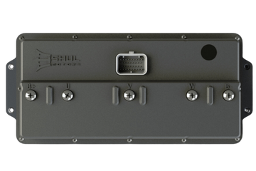

Suggestions please for specific controllers currently available
to allow for getting maximum torque at lower RPM ranges, as in starting from a standstill facing up a big hill.
Assume 50+ pounds of top notch cells at whatever the best voltage is, max speed say 20mph on the flat with a tailwind.
Likely FOC would be best right?
Something with enough phase A and MTPA would be best as far as I know, I think a good candidate would be Hesc cl1000
https://3shulmotors.com/shop/cl1000/?v=f003c44deab6
Not sure if 1000pA is enough to get max torque at low rpm though, a fardriver nd961800 should do the trick otherwise.
But I dont think it can take advantage of the motors saliency on low rpm, someone with better knowledge will have to chime in what would be best.
Higher voltage would be better, but hard to find controllers for it.
I might as well note that higher voltage wont give more torque, but higher rpm.
Then you can gear lower, and get higher torque on the wheel.
Is there a guide you can direct me to for setting up MTPA? I’m finding very little info. I’ve got the cl1000 and qs138 motor
I am no vesc expert, but I think you just activate the function when the motor is set up properly.
