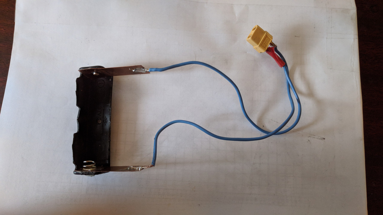

On the other hand, if you clamp too hard you can dent the cell. I have dented some cells when pressing too hard with a spot welder, specifically on the positive side of the cell.

john61ct said:The clamping force needs to not be via a low-area "point", but spread over a flat contact area in order to lower the pressure psi.
Better electrically too, more surface area for lower resistance higher conductivity.
There are conductive epoxies as well, the physical cell-holding force does not need to be exerted by the electrical connection.
Sorry, don't follow.liveforphysics said:If you have a limited amount of contact pressure, you will find a point pretty fast where more surface area hurts the joint.john61ct said:The clamping force needs to not be via a low-area "point", but spread over a flat contact area in order to lower the pressure psi.

Very well clarified, thanks again.spinningmagnets said:If the contacts are also made from a very stiff material, microscopic irregularities means that there will be more pressure applied in one area, and less in another
liveforphysics said:This is why solderless packs aren't a mechanical design problem to solve as much as a materials tech challenge to select things that won't let force creep down to nothing after sitting a while.
BlueSwordM said:What do you mean current capability is too low?
That's why I've made my own BeCu spring design
Nickel plated BeCu C17530 springs.
In a dual spring setup, they are absolute monsters, and have no problem handling 20A+ currents.

BlueSwordM said:Also, this is quite the lengthy spring.
By making it shorter, I can easily lower the resistance of the spring.
