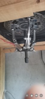

Still in the process of tuning the Fardriver controller. I'm slowly cranking up the power, trying to find the limits of my motor without killing it... Risky game...
So, in an attempt to give the motor every possible chance of survival, I decided to feed it a little bit of magic potion: statorade!
Since it was impossible to find the "official" statorade here in China, I had to find an alternative. So I used a product from Ferrotec, the MPG2100, which is a liquid used for cooling high performance speakers.
So I had to resort to open the motor, which usually it a giant pain to do. Mostly because separating the stator from the rotor is really, really hard, you usually end up bashing the motor on the ground dozens of time, every time risking damaging something... Well, not this time!
This time I used a bearing extractor:
First taking out the motor and putting it on my table, which has a big hole in it, making the whole process a bit easier:
And then using the extractor from the bottom to push the stator upwards until it separated from the rotor:
If you don't have an extractor and you plan to open your motor someday, get one asap. This thing paid for itself just with this job, it made the whole process a walk in the park!
I've got this motor for 5-6 years and got it second hand in the first place... I was expecting to see rust, I was expecting to see burned copper, magnet flakes all over, dirt, all kind of crap.
I sure wasn't expecting to find the insides in a pristine condition, this thing looks brand new! :shock:
Considering how hard I have been riding this motor for the past years it is amazing. Keep in mind this is a 3000W rated motor and I've been running it at 15-20KW for a while now.

What size is the motor, is it 205 50h?
I think it looks bigger in the picture, maybe more like 273 40h.
How much ferrofluid did you put in there? I think 10ml is recommended for a 205 50h.

Yeah it's a 273, probably 40H but I don't know.
I didn't put a lot of ferrofluid, probably a little bit less than 10ml. I've red somewhere in the forum that it wasn't necessary to put a lot. I had nothing to measure precisely.
