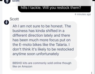

I wanted to order a Ludicrous BBSHD kit from LunaCycle, but saw they are out of stock of 68mm. I sent a message and they were very quick to respond, made it sound like these kits are now a thing of the past… I had a BBS02 on a previous build but that occasionally got too hot. (Hilly gravel terrain) Is there anyone else that sells a modded version of BBSHD, or am I stuck with the stock version?
It is a thing of the past, marcos and Luna do not support even the existing owners of their Ludicrous controllers and abandoned their official threads on their official forum about those Ludicrous kits
There is an open source INNOTRACE Shrimp motor controller you can solder that should fit inside the BBSHD motor.
