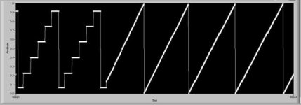

:? first useful output from my fooling around with the 30F4011... Got one of my hallsensors glued in backwards :shock:
Thinking about it after the fact, it fits, wasn't paying attention. Halls are now setup for a 60 degree motor.
Every line is a measurement. I call my sensors hall1, hall2 and hall3. First colum: rising edge hall 1 (and since
this automatically resets the 8.5 usec timer it is by definition 0 degrees), Next colum: falling edge hall 1
(which comes after about 48% of period time as the count is 48% of first colum). After that rising
edge hall 2 (67% of period time), falling hall2, rising hall3 and falling hall3.
Hall 3 seems to be the most off by about 3% (or 10 degrees). And one of them is glued in backwards :D
To get the numbers i give the motor a whirl and press a key on the laptop. The algorithm captures the content
of a timer on rising/falling edges of hall sensors. The rising edge of hall 1 is used as a reference. To
make sure the measurement is valid the algorithm runs a 2nd order prediction filter to make sure the
measured period time makes sence, else the measurement is discarded. The prediction filter is
2nd order so it can predict constant speed and constant decellaration without error (measurements
are discarded if the prediction is more than 3% wrong)....
For the controller there'll be no issue as I plan not to relate the hall sensors to the motor phases. Switching
of motor phases will be dictated by the prediction filter (which can also extrapolate to accurately switch
inbetween 2 hall sensor edges) , the halls are there for synchronisation. To make sure that
in my mind I don't relate the halls with the motor phase, I call those phase A, B and C (got this
idea from a comedian, in a sketch one team was team 1, the other team A :D so non would
feel inferior)

I reached the point where:
-the system now auto calibrates the hall sensors. During calibration it asks you to spin the motor. The 30f will
then measure all hall edges and determine their position relative to each other and the rotor. How you connect the
hall sensors or whether you have one or more inverted ( :oops: ) doesn't matter.
- after calibration the info from the hall sensors is used to determine the rotor position. This will typically yield
one out of 6 positions (360 divided by 3 and divided by 2 edges (rising and falling as produced by hall). These
are, in the ideal world, 60 degrees apart. Here however the system knows the relative position of each hall,
the distance in degrees is typically far from 60 degrees and depends on how good the hall sensors are positioned.
- while the rotor is spinning the 30F tries to determine the rotation time (based on info from the hall sensors,
their distance to each other in degrees and info from an internal Timer). When the rotation time is known the
30F jumps to a mode where the rotor position is determined by the last hall signal edge, the time since
this edge and the rotation time.
this is shown in this plot. On the x-axis is time, 1000 points per second. On the y-axis is the rotor
position (0 to 1 corresponds to 0 to 359 degrees). The first 0.3 seconds the system doesn't have an accurate
prediction yet of the rotor speed, therefore it outputs the position based on the hall sensors. This is why it's
one out of 6 levels. After 0.3 however the system 'has lock', now interpolation is used to calculate the position
also inbetween the hall sensors, this is why the line is linear rising instead of being 1 out of 6 levels.
In the mean time the system will keep monitoring how good it knows the rotor position. If something unexpected
happens (like massive deceleration, only possible by locking a wheel or something catastrophic like that) or
the rotation just becomes too slow (were talking 10 rpm here) the system loses 'lock' and will switch
back to using the info from the hall sensors again (so it goes back to the 6 levels). An example when this
happens: when you've come to a stop at a traffic light....
