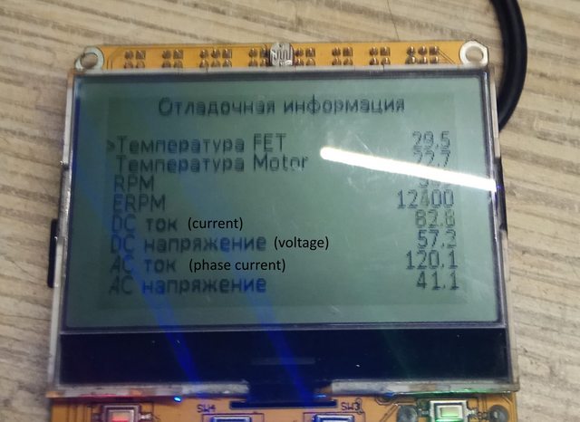

Support for torque PAS sounds great and also the thing with the gearsensor (which i think is difficult to deal with to make the torque interruption smooth).
Will the controller support field weakening (in FOC mode), and if yes, will it be possible to set a flux weaken current in ampere, or will it be some kind of phase shift in degree?
Whats the PWM frequency?

FW already supported and can be used, setup current in ampere
PWM 20-25khz
Can PWM frequency be set manually?

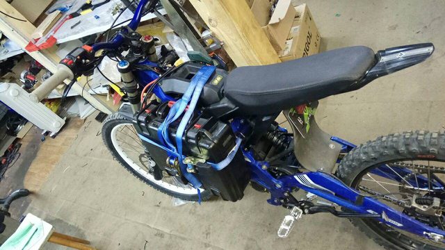

I'd got sur-ron with 60T rear sprocket, quickly equipped battery and 12F controller for test ride..
200Aph 120Ab 60V with peak 7250W, max speed 55kmh.
Well, it looks like almost original controller with 48T, accelerates quickly but have more power. (even more if equip 20S-22S battery)
But i think this kind of device needs 24F controller for really fun ride, so now i have new goal :)

That's a good looking unit you got there, like the blue color. What you reckon max peak power for the sur ron will be when you get your new 24 fet controller ready? And what will be max safe voltage to run?

Owner of bike planning to make 20S battery.. with 200Ab max, so 15kW.
Absolute limit for 24F controller may be 25kW
