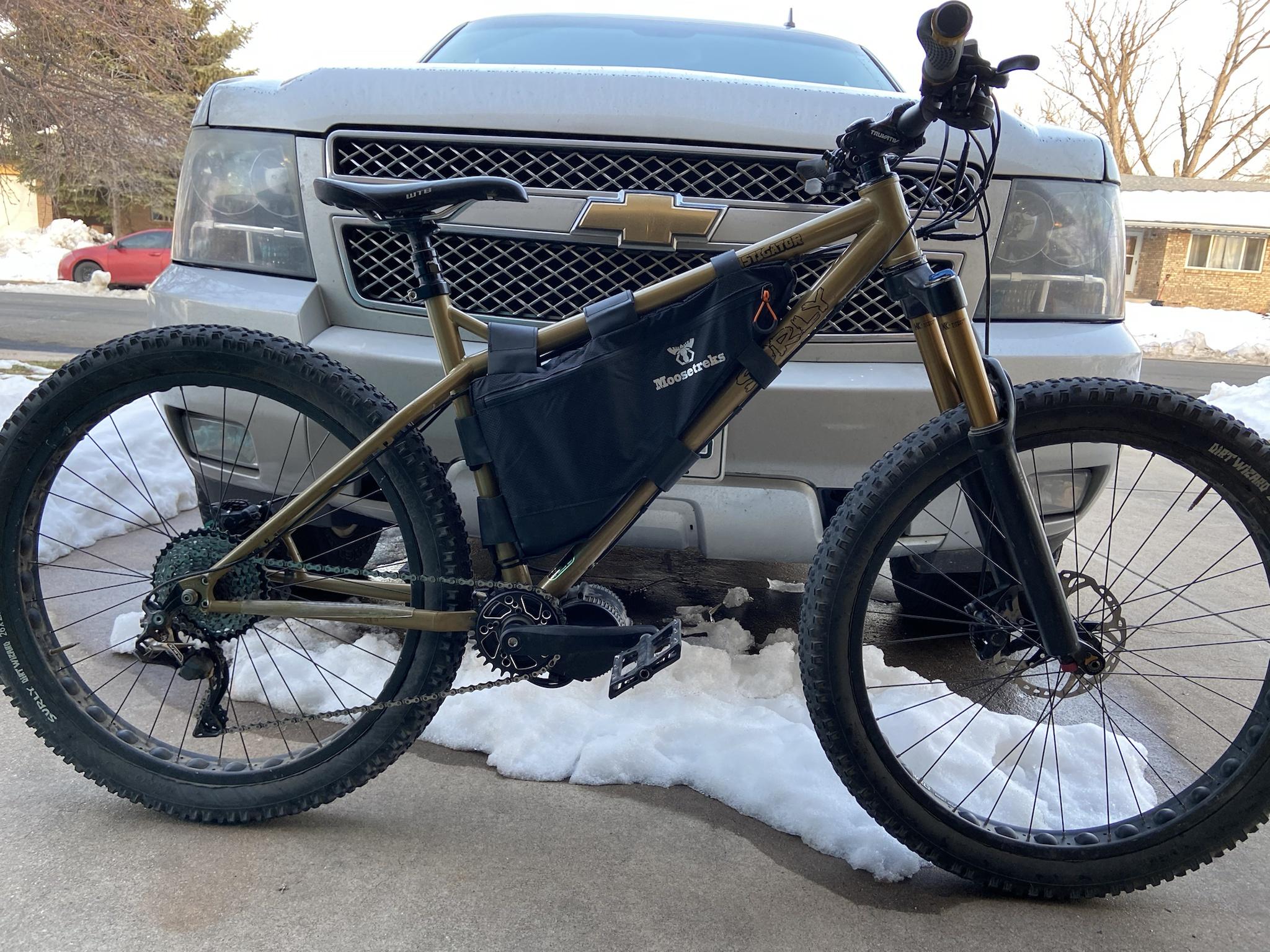

I just mounted it vertically in the frame bag. I did not want to go the seat mounting route as I have a dropper post and the battery and bag is about 6 lbs - lighter than most batteries but would definitely slow down the dropper a lot.
I love the utility of the frame bag - I can also fit a pump, .5 L of water, clif bar, bike tool, and my phone in there, just not the quality of this particular one.
If you want a size reference, the bike is a 17" surly instigator 2. the triangle looks to be about the same size, if not smaller than yours, but I obviously don't have a rear shock to contend with.

We have very similar setups except I have a 13lb battery which really kills the nimble feeling. I went with recommendations from others and it's just not what I'm looking for. The bike is HEAVY!

13lbs is a monster. That + the bbshd and I'd guess your bike is in the mid to high 50s. Mine is barely under 50 and it's a lot heavier than I'd like.

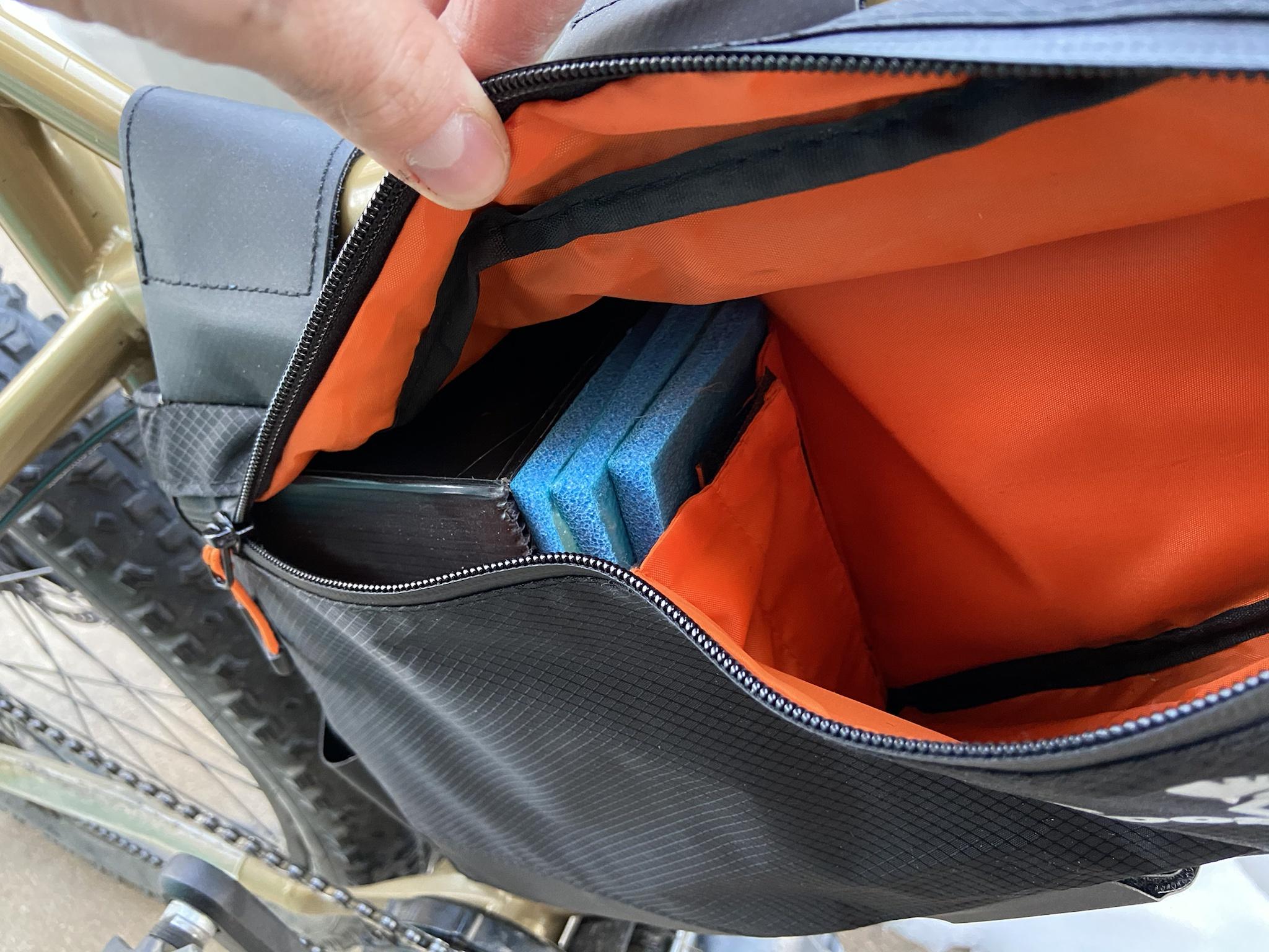

In addition to impact and vibration resistance; I'm suggesting the foam padding and rubber bottom around the pack to take up the extra space and limit how much the pack will shift around inside a triangle bag.

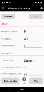

I have not been able to find a definitive guide of how to setup my settings to smooth out the jerkiness when applying the throttle. If you have screen shots or some post that clearly identifies what settings to configure that would be of great help.
I use assist and throttle at the same time I dont have that issue just pressing the throttle button seems very jerky. I use the 9 levels of PAS set to Off Road. I typically stay on 3 or 4. See the attachment the two settings I mention have helped quite a bit. But if there is something out there that's better and smoother then I'd want to try that.
I've actually replaced the blue bike and no longer have that huge 17ah pack in the triangle. I've gone to a much smaller 8ah 52v pack. I dont have it mounted in the ideal spot but I dont think I notice the 5lbs weight under my saddle. It would make more sense to place it directly above the motor to lower the COG but this is going to require me to build a custom bracket and mount and I'm too lazy. I have several heavy duty zipties securing it making it a bit less sloppy to bounce around.

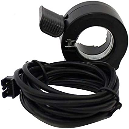

If you're using the common Wuxing 130X throttle, understand that it is part of your problem. Not all throttles are equal in how they deliver signal to the controller, and this common kind of throttle is particularly abrupt.
Figures that looks like exactly what I have. Is there a difference between the thumb throttle and 1/2 throttle grip? I havent tried the throttle grip yet. Just wondering if how much of a difference that would make and clear up a bit of clutter in the cockpit.
