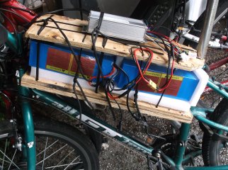

And the other one, I'm going to build a rack..out of wood to hold 2 other 36v/30A batteries in series. It needs to be strong enough to not break if I have to hop a curb every now and then. I'm using wood and stock bike rack uprights. I won't have much problems building a rack and mounting the batteries and taking the
controller and throttle off the big triangle bike and putting it on the other one whole with a switch to a front hub motor.

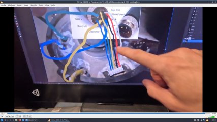

What's got me worried is hooking up a controller and throttle like that to a bbs02 with the 72v battery rigup. I need to know the wiring for that, and I want to kinda know what I'm doing before I go in, and I'm going in soon.
The front wheel drive 72v conversion will be done 1st.
Any wiring diagrams/charts/pics/videos to hooking up like.. a Komodo to a Bafang motor would be appreciated. TIA.

Why not just run a big hub instead of 2 motors, ie a leafbike 1.5kw? 16lbs instead of 22lbs of motor, and higher efficiency..
Rear racks wag a lot and negatively affect the steering of the bike because they're in the worst place for weight on a bike. That's going to hurt your handling. mount these big batteries in the center of the bike if you can, even if one is sitting on the top tube.

I'm not going to be using a Bafang controller at all. Going to wire a Komodo or KT controller to run the BBS02. That's the plan.
with 72v and 30 amps.

Thanks for the rack info. I might could build something in the center, that something will involve drilling through the frame tube. They need cushioning, though.

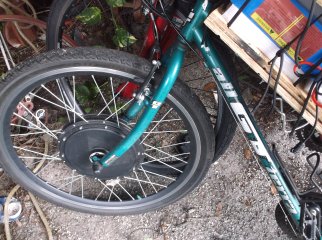

I'm doing 2 separate bikes. One is getting fronthub, 72v and probably a rackmount batteryage.

Well, I got dual Caomi batteries on a front Voilameart hub. Oh Boy!
It's pretty crackery. Guaranteed to attract The Man's attention cuz it looks like a couple of bombs
strapped to a bicycle whippin' down the road.
That's too much weight and bulk, man. That's ridiculous, I'm not doing that.
Also, is it me, or does that look like 2 big packs of firecrackers or dynamite and fuses? :ROFLMAO:

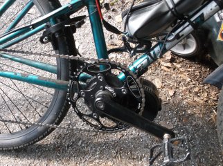

Do you pedal? If so, that's a bad idea. I had to shorten the cranks on my BBS02 to 152mm so I could pedal along with its efficient RPM at 48 volts.
If you don't pedal, no problem. Enjoy your anemic moped.

I'm rolling with 165mm Bafang masterfully crafted aluminuminum.

If your results are agreement with mine, you won't have an efficient pedal RPM and motor RPM at the same time. Pedal RPM will be too low for the motor and motor RPM will be too high for pedaling along.

36T on front. TBD on rear. Right now probably 28 fer starters.
Derailleur action is next. Probably get a cassette hub rear and I got a big sprocket and another I can cobble up.
Right now it's gonna be run what ya brung.
Yeah that's a major problem with these addon drives that can't be regeared

The uh, hall diagram used in this thread works. It's quite quiet. It runs like a top.
You have to keep a second-to-second-and-a half- delay in mind, though.

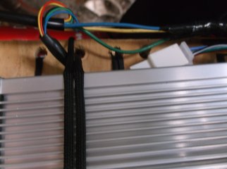

Did I ruin 2 BBS02 controllers to do this? Yes.
I coulda sold one, gah! Pulling it out I yanked the purple wire. Now it's butchered and the other is an empty shell.
I used the power cables for the phases. Went to buy correct colored wire, did not happen.
Home Depot or Lowe's has this uh..220 like RV plugin cable that has all the correct colors in it if you get it and split it all open and there's paper, too. It's black and like almost an inch diameter. Yeah well, nobody came to the wire that day, so I proceeded with what I had. It works real nice. Maybe I take a pic.

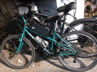

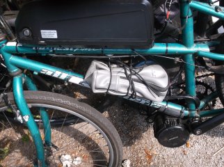

So now it has a 48v shark battery bolted through the top rail, a Komodo controller.
There only 1 initial bog now, and it will go a long ways, but not that fast with my fat ass.
This is just about about the final form. Gonna put a 10-speed on it and rig that up.
That's it. It'd probably be fantastic for a lighter dude.
And then I peanut buttered it. :/
Pfft. Here's what I'm gonna do after fixing the peanut butter gear:

It ran fine and smooth, and I think I overdid it. Downhill, pushing over 200 lbs @ 30mph on a 26 incher. eh.
Got real hot. 26" is too rough for me anymore, I'm going 29" hardtail with maybe suspension seat.
