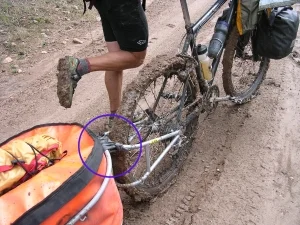

Hey Guys,
I found the information for correcting the twitchy BoB type single wheel trailers.
Now I have to find a bike inter tube............
See the info here,
1. Inner tube dampening system.
BOB is your friend, but as all friends do, sometimes he gets a little too close for comfort, bouncing and swinging around at you. Creating a slight dampening system can help your BOB track better behind you and reduce the swinging and bouncing that can occur when you are riding more bumpy or technical terrain.
Take an old inner tube and cut it so it is one strip.
Start with one end and wrap it even between the BOB yoke and the trailer, crossing over with even tension on each side. Tie it up and give it a test run.
If your BOB doesn’t pivot well or track behind you on corners, you probably have it too tight.
If it still swings around too much, you probably have it too loose.
Adjust as needed.
Your thoughts or suggestions...........

Well, I tried a bike tube for sway control......with 50#'s of weight.
It does work, now I have to adjust the tension to get the proper results,
4 wraps on one side and 5 wraps (different spaced bars), I'll add another wrap.
Using a 16" tube, need to get a narrow road tube, longer for more wraps.
Tia
For an easy way to see the tension on each arm, lay a straight section of rod/pipe down the center of the trailers length, temporary tape in place to hold it there.
Take a fish scale that goes at least 20 #'s pull, tie a cord to the end of the bike arm arms, (thru the bobbin locking arm spots), pull the arm towards the straight edge, to about the same distance as when attached to the bike bobbins for the arm spacing.
Read the poundage from the fish scale, (the inner tube wraps tends to pull the bike arms attachment outwards), repeat on the other side and adjust the wraps to get the same pull readings per side, and the twitchy trailer sway is controlled when hauling the load needed.
A longer narrow road type inner tube works better, cut off the valve core area, then split into 2 equal halves lengthways, better uniform wraps per side........
Do not cut off the excess tubing, until you are finished testing......Don't ask..........lol
