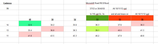

Figuring out proper gearing for my ebike for my preferred cadence
I have no clue what my riding speeds are but my 48-14 gearing seems to be close for my cadence (no clue but guessing its 65-70rpm) and cruising speed I like to ride, literally no clue on the actual speed I like to cruise at.
301 gear inches of development for 48-14 on a 700 x 45 wheel.
Switching to an 11-xx freewheel might do the trick with 383 gear inches.
An extra 82 development inches or 21.5% more (hopefully the math of 21.5% is right :oops:)
I want to see what my cadence is when I am riding my ebike at various speeds so I can gear the bike properly. Which is why I found that cycle computer cadence measuring Instructable posted below.

I feel as though I need an extra 6-10kph at a cadence of 70.
The cheap way to find out if I like that is to just buy the cheapest 11-xx rear fw.
Then if I want to plunge and go 13-xx rear fw, the 7/8 spd Microshift triple front derailleurs are cheap in 52 and 53. Middle crank would be 10 below, and small 10 below middle.
53/43/33 which is close to my 28 small I already have for the really steep long hills I literally always avoided in the past.

Testing on the 14-48 - Just cruising on flat ground with some small, non steep hills that were just powered up.
These cadences felt good to me.
35kph is 75rpm cadence
30kph is 65rpm cadence
25kph is 55-60 cadence
Prior to the test with all the riding the 3x7 gears feels so wonderful to have on the hills then 1x7 with only 4 gears working on a triple crank :lol: I can never see myself really moving towards a 1x crank and 9, 10, 11, 12 speeds. Things start getting very expensive, and I'd need to switch that stock rear wheel from a fw to a cassette. I'd consider a wide range IGH, but maybe I'd couldnt have 3x crank with that, doesnt matter not on my plans at the moment.
New setup - I will be using 3 or 4 gears most of the time, 14-48 cruising and 1 or 2 random fw gears in middle 38 crank gear for the lame hills I power up mostly, but I do want a good workout on steep long hills the 28 crank gear and whatever the biggest gear is on the fw which will be very very rare. I can think of 2 or 3 hills to test that on.
From that calc website, 28 crank and 34 fw is 6.7kph at 60 cadence for hill climbing.
