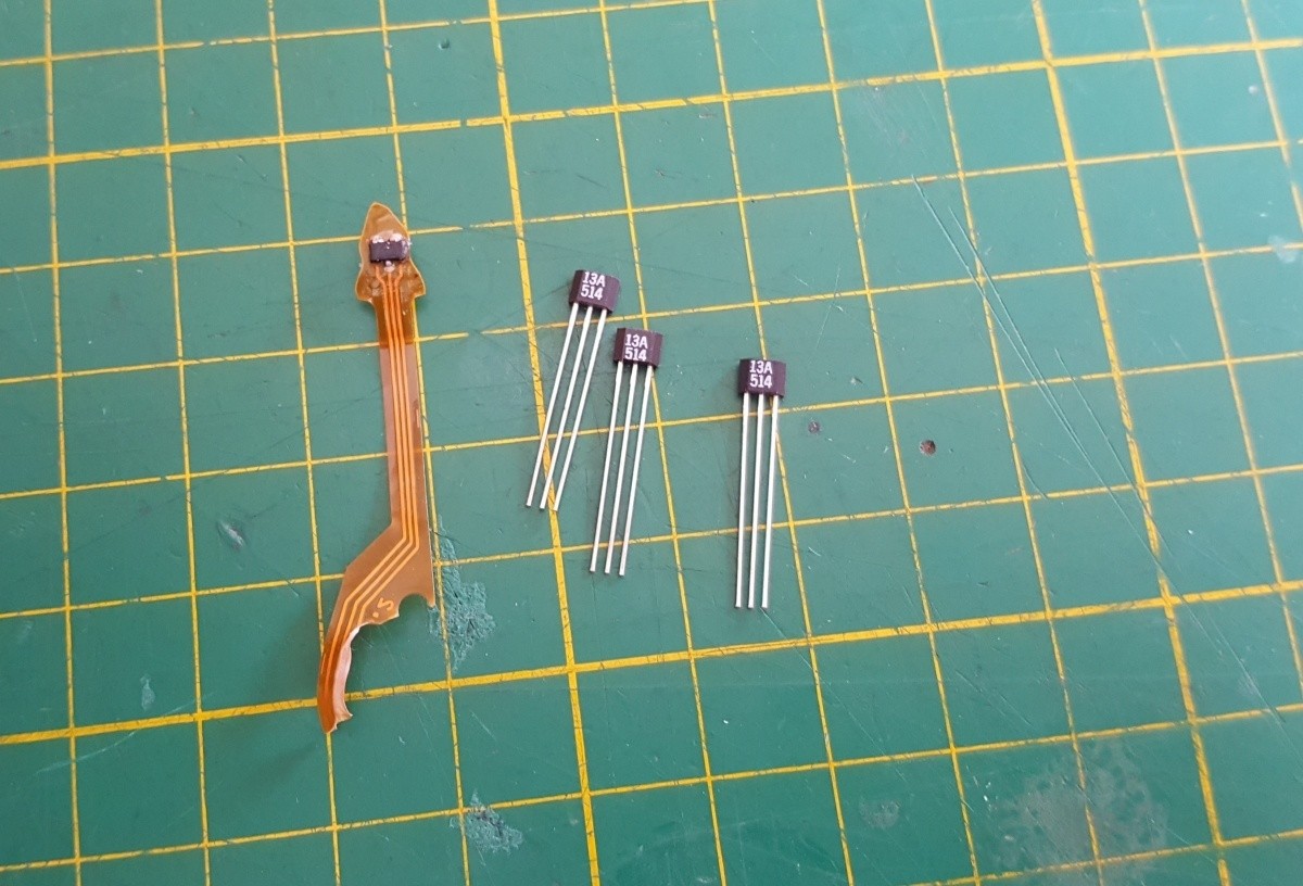

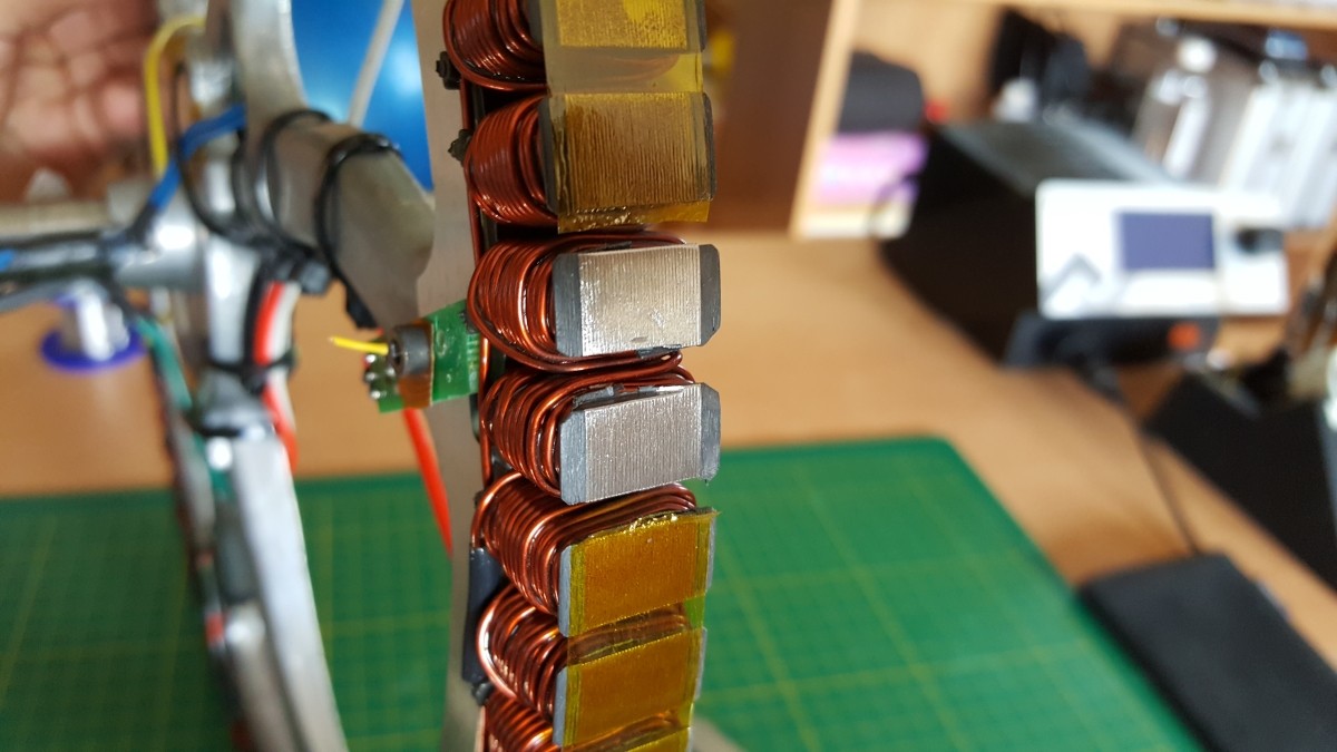

Swapped the halls for SS413A. It was necessary to grind off a bit of iron from the stator teeth to make it fit between.
I used a dremel with a small diamond disc for that. As glue i used CA.
Well, how was the result?
First thing i noticed when following the "find the right hall and phase wire combo chart" was the motor stuck, what it did NOT DO before.
Before it was vibrating, but never stuck like usually hubmotors do when going through that procedure and the combo is wrong.
OK, so something MUST have changed in terms of signals or response characteristics.
When i removed the halls for grinding and brushing the stator surface, i broke one of the foils with conduction path from the small board to the sensor.
I than repaird that connection by soldering wires to the sensor. It could be that this wasn't optimal because one or more of the three wires where now located much closer to the windings which could have distorted the signal quality.
This tells us if a LED blinks on a cheap "multifunctional motor testing device", it doesn't mean that much..

Allex said:
Are SS413A better than SS411A in some way?
The only difference is the gauss sensitivity.
The 413A needs about twice the magnetic flux to make it swith compared to the 411A.
When i was nearing with a magnet it was switching already at 3cm or more distance between magnet and sensor so i think the 411A would not make anything better.
