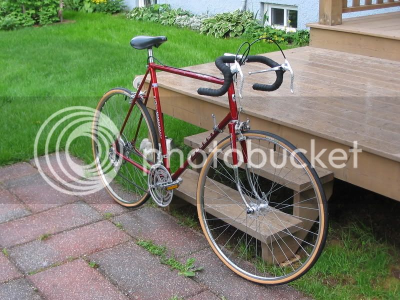

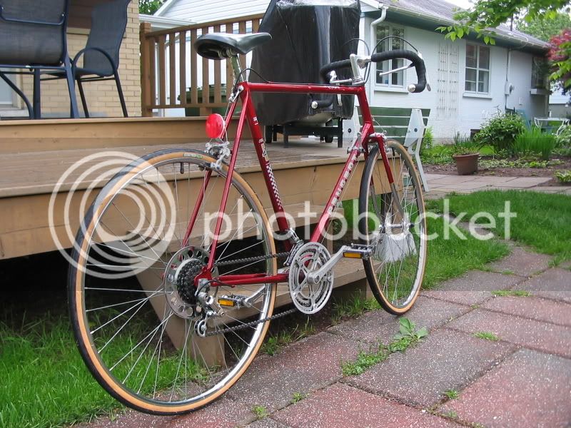

*Shrugs* May as well post this here & stuff.
Got this one a few days ago, needed new tires, tubes, bartape, a quick wash up, oil, tuneup & fitting - though needs a different seatpost to get the saddle angle right. Oh well.
Rear reflector has to go... But the dork disk is awesome!

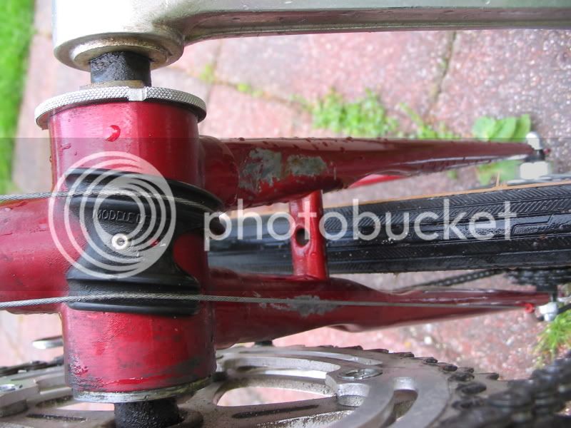

Previous owner damaged the paint and crushed one of the chain stays with a poorly installed kickstand...
Good thing it's not alu or carbon... Steel is real.
nice...
how's the shifting? do you ride without a motor often?
and you may wanna tilt that seat down :)
you also may wanna ditch those platform pedals and get either some shimano "spd" clip-in pedals or "time atac" pedals, both of which I use... time atac's on the fixie and spds on the other bikes. (time atacs are much less likely to unclip when you are pulling up hard on the pedal)
and some shimano 105 integrated shifters/brakes would make your life a whole lot easier :eek:
<img src="http://www.bicyclebuys.com/productimages/1010227.jpg">
Hehe, well I blew up my last 'lectric bike at some point during winter so yeah, I don't ride electric very often these days... Though by next winter I expect to have a sexXxy 409'd Finelli up & ready for action.
Shifting on this one is awkward, I've been spoiled from XTR, revving up from a stop and then going snap-snap-snap while accelerating without even easing off the pedals except to change rings... So the best I can describe this one is that it rides like a singlespeed with many speeds to chose from. Pick one and stick with it, change occasionally. Taking hands off the bars to shift feels wrong. Otherwise, indexed shifting is much better then I remembered it to be, fast & precise, though I do have to trim the front dérailleur a little as I go from one end of the freewheel to the other.
I dig this bike's vintage look, so the gumwalls are there to stay & brifters would look wrong, though indexed downtube shifters would be sweet if that exists. The metal dork disk is likely to stay also, but that depends if I get around to doing some fancy lacing on the rear wheel. For the pedals I was thinking of just adding powerstraps to them if possible, old fashioned clips would look better but they've always seemed somewhat impractical to me. And, not gonna go clipless.
Rear reflector should get a blinkie to replace it soon-ish, as soon as I can find an 2 AA blinkie that screws onto a reflector bracket for a reasonable price. Shops here seem to carry only either cheap AAA blinkies and expensive (54$?) AA blinkies... I have an AA charger that takes a pair of cells at a time. Something like a vistalight super nebula 5 would be great if I could find one.
Edit: Looks as though Vittoria don't make 27's. Current tires are bottom-feeder IRC 90PSI things... They were the only 27's the bike shop had, and the front tire was getting a hernia by the time I got there so that kinda settled it.
