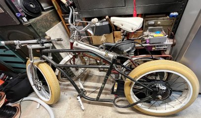

Pictures?
It's all a pile of bits at the moment, but as the bits come together I'll post some shots.
Heres the new project in front of the original one in a fairly stripped down state.

Cranks as a kick stand, I like that.
Any bends in the track though? Because it's a flexi frame, could get hairy going around corners.
Nice project. I hope you'll add more photos to this thread when building as I love following this kind of projects. Good luck and enjoy the build.
