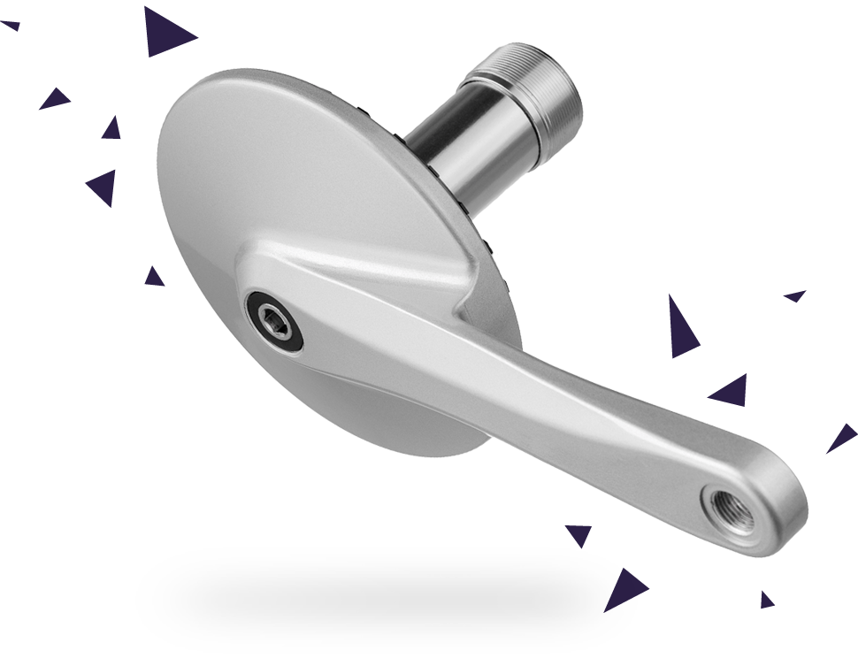

I also once installed an efneo front gearbox:
