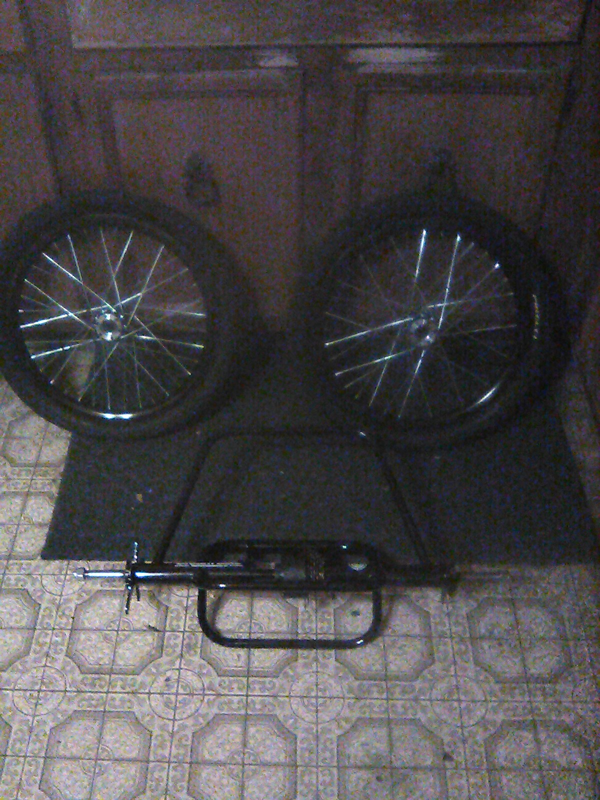

My parts to convert a trike into a quad arrived over a week ago.

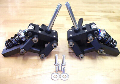

Since KMX are no longer being made, and since the spindle is the weakest mechanical part of the design, I am heavily considering an alternative front suspension to the one I used and Adam Roy designed:
UTCustom KMX Front Suspension Upgrade
UTCustom Ackerman Compensator Steering Upgrade
UTCustom Revolution EC34/30 Headset for Sunseeker Trikes (each)
This alternative design uses spindles from a Sunseeker, which are readily available. Only 1.25 inches travel, not as wide of a front track(advantageous in my case for aero, since by going quad I don't need a massively wide front track to corner at high Gs), but unfortunately they are not gas shocks ad I will lose the 3 degrees negative camber.

Ordered the suspension parts and motor adapters for this quad.

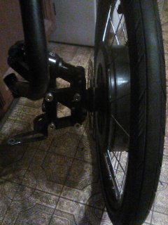

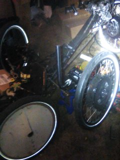

The right-side front hub motor is installed. I'd have had it on earlier, but my parts got held up due to customs. My plan was to have it installed during my vacation last month, but since the part arrived after, it may be a month or two before I have the quad conversion complete. We'll see.

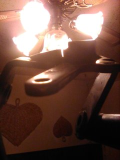

I'd have done the left side installation today as well, but I needed a spindle repair. The left side spindle has never been repaired before, and I'm glad I took the trike apart to catch the crack. The right-side failed in 2022 at 40+ mph and was repaired, and was still in excellent shape in the present.

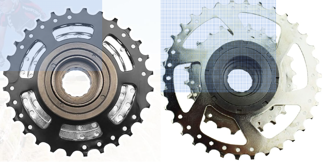

I took the differential apart to fit a DNP Epoch 7sp 11-34T freewheel, but the composite differential was built for a specific pattern found on the granny gear of the Shimano 7sp 14-28T freewheel that the conversion kit came with. The pattern on the granny gear of the DNP Epoch was angled and it didn't fit the differential.
I require a wide gearing range, and the fact that the DNP Epoch didn't fit was a massive disappointment. I got the differential back together. In my attempt to find a more suitable Shimano freewheel, say a 13-32T(since Shimano stopped making the 11-32T version in 7sp over a decade ago), I came across something with a similar mounting pattern to the Shimano that the differential came with.
That is a MAKELEN 7sp 11-32T. I ordered one for $16.99+shipping and I'm hoping it will fit. If it doesn't, I have another spare freewheel for my hub motor whenever I get the other trike assembled. If it does fit, I'll have an 11-32T range for my quad. I have the front hub motors installed and might have the quad operational this weekend, right in time for a snow storm. The Shimano 14-28T will do just fine for now.

I'm not clear on the fit issue. 'Angle'? Most of the available freewheels are reasonably compatible with ISO standard threading (except French), but apparently mismatched threading isn't the problem... or is it? Who made the differential you are attempting to mate.
The differential has 6 square-shaped notches cut into it, each notch 3-sided. The granny gear is what the composite housing of the differential mounts to, using set screws to mount both the freewheel and the differential to right and left shafts respectively.
Below are images of a freewheel that matches the available pattern on the differential on the left, and a freewheel that I tried to install that didn't fit the differential on the right:
My differential was sold by a company called Dream Bike out of Brazil. It uses 15mm axles with keyed shafts, where an M6 bolt is used to lock the differential and freewheel to the shaft.
