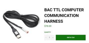

I shall buying an bac855, and trying it.
Do I need usb cable or can I program it through Bluetooth?
I see that their is Bluetooth version is.
I can buy bac 855 but not program for bafang.
I the bafang configuration available?
For the usb cable they ask 80$, transport and import tax it shall be more than 100 euro for cable, can I made it myself? Or use Bluetooth?
It's like also some protection, you need to buy evaluation kit 1000$ to program it, or not?
These company looks absolutely not transparent.
Can I find the information for program the bac 855.

Now connect to a computer.
I have find connection cable, too much money, can make it better diy.
If anyone knows how to connect to USB and the motor?
