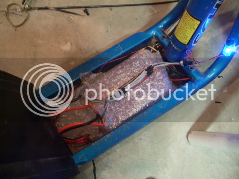

My battery nest and Parallel balance harness
I also soldered a jst plug to the main parallel connector, and I have a bec plugged into that. I had problems with too much voltage goinng to the servo tester; I hope a fully charged lipo isn't too much for the 22.2v input on the bec.

It doesn't take induvidual cell voltages, only the whole pack voltage. The wires go one on each end of the included balance connector.
These packs being 20-30c, they are under very little load in an e-bike. Even if they weren't, if you take good care of your packs they shouldn't go too far out of balance. Mine stay pretty balanced, and I have a balance charger. That balances as it charges and I also have an astro blinky balancer for balancing off the charger.
